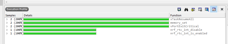

To achieve code profiling, ITM (Instruction trace macrocell), and SWO trace, the SWO pin is enough. I have managed to send some data using ITM_SendChar(); and I can see the data on SWO Viewer. I cannot see anything on IAR'ss terminal window or the timeline window where I am expecting to see some graphs.
I have searched online but hardly found any tutorials for Jlink, but only I-jet. To get down to basics, I am now using the nRF52840 Dev board, and using its on board programmer. For sure SWO works, otherwise I could not see the data on SWO Viewer.

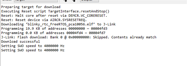

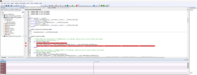

i am using the simple blinky freeRTOS out of the box example. As you can see in screenshot, I do not see anything in SWO Trace Timeline:

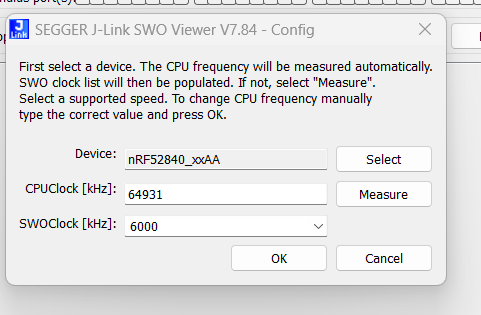

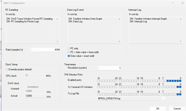

For the SWo configuration, I am using the following values:
In the bottom left, I have tried a number of combinations, even what the SWO viewer tells me by default which is 64 MHz core clock and 6000 KHz SWo frequency:

  • Hi Muhammad,
    First of all, we are not so familiar with IAR compare to other IDE such as SES or KEIL. I'm having a trouble installing it because of some licensing issues.
    Since the SWO interface works but not in the IAR trace debugging window, have you tried to contact IAR about the issue ?

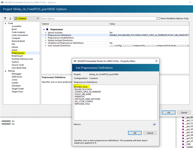

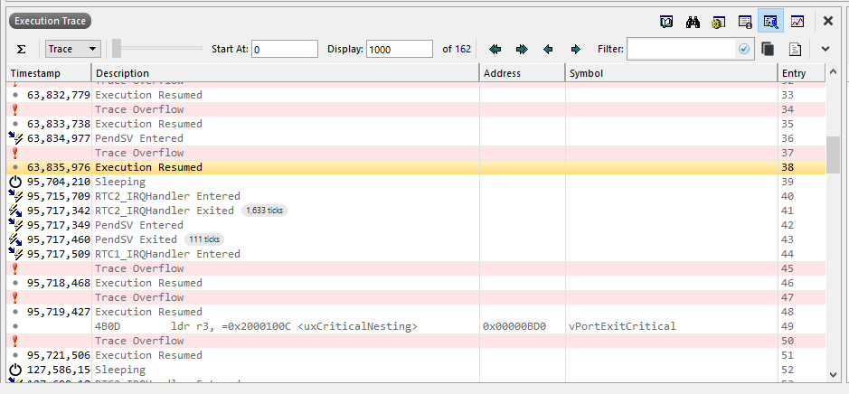

    I did a quick test here with Segger Embedded Studio and SWO trace seems to work for me.
    I was testing with the chip on the DK. What I did was to add ENABLE_SWO to the preprocessor symbols
    And select SWO in the target trace.
    Do you have SES installed ? Could you quickly try this with the DK first and then if it works try with your custom board ?
    If it works on SES I would think it should be very similar to set up on IAR.
    I attached the project here, it's built with SDK v17.1
