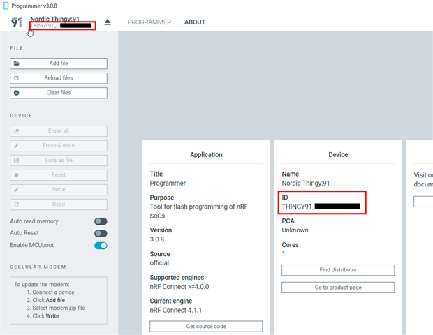

How to get the Device ID shown in the Programmer : About-Device section from AT commands?
I'm connecting my Thingy:91 for the first time, and trying to understand several things.
1. How do I determine what factory Firmware files (hex files) was used to program my device?
(I was hoping to find them in the download section, but since I cannot find what was used to program the device, I don't know what to download.)
2. In the Programmer application there is section under the ABOUT tab, called Device. Here you can find the ID that is shown in all apps for the device. (See screenshot.)
(a) How can I find this ID, and where/how is it defined?
(b) Can we find it using AT commands?
Thanks in advance.
    I do not think we can find this from AT command. You can find the device ID (https://infocenter.nordicsemi.com/topic/ps_nrf9160/ficr.html?cp=2_0_0_3_4_0_8#register.INFO.DEVICETYPE)from memory read command by using nrfjrpog.
    For example, this is my device ID when Thingy:91 is connected with external debugger (nRF9160).
    Thanks.

  • Hi Kazi,
    Thanks for the info, but I am not able to run the program you suggest.
    Opening a Bash from nRF Connect for Desktop:
    $ cd /c/mydev/ncs/v2.4.0/zephyr/scripts/west_commands/runners
    $ python.exe nrfjprog.py --memrd 0x00FF0204
      File "nrfjprog.py", line 11, in <module>
        from runners.nrf_common import ErrNotAvailableBecauseProtection, ErrVerify, \
    ModuleNotFoundError: No module named 'runners'
    It seem that there is a python package missing.
    No idea why, as it was installed by your installer.
    UPDATE:
    Apparently the installer did not install the "nRF-Command-Line-Tools".
    www.nordicsemi.com/.../Download
    Now I get another error:
    $ nrfjprog.exe --memrd 0x00FF0204
    ERROR: No debuggers were discovered.

  • Hello Emanuel,
    ''Thanks for the info, but I am not able to run the program you suggest.'' - could you please tell me that which program you are mentioning? I am sorry as my second reply did not satisfy your queries.
    ''Apparently the installer did not install the "nRF-Command-Line-Tools".
    My operating system is windows and here is no problem to install nRF command line tools. I am not sure about this. I will ask our team will give you a feedback.
    Let me say again about device address a bit more again. I showed you to see the device ID for nRF9160 ( when the switch is  turned to nRF91). When it is nRF52840, we need to use the address for the register of that chip. for device.addr it is 0x10000064. nrfjprog --memrd command shows the following output.
    However, none of the IDs' are close to what we can see in the about tab in programmer app. I have found a code https://github.com/nrfconnect/sdk-nrf/blob/main/applications/connectivity_bridge/src/main.c that shows hoe device ID set in the application. So, it is clear that device ID is from deviceaddr register.
    I will ask the specific team about this ID on the programmer app. I am just curious why do you need this information?
