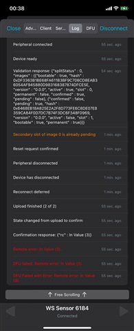

Below are some screenshots from nrf Connect Mobile for iOS showing "success" when using "app_update_bin" but failure when using "DFU_application.zip".
I have also included the log from nrf Connect for iOS when it fails with the multi-image update.

  • Hi Andreas
    Unfortunately I am traveling until Thursday - so don't have all my tools and/or devices handy to test 1 & 2 above. So will have to try that later.
    I had in fact tried it on Android and got the same error. As I originally tried it on a fairly old Android device, I just tried it again (an hour or two ago) on a recent Lenovo Tab M10 HD running Android 11 and the latest nrf Connect app for Android. Same problem.
    Below is a copy of the log from that Lenovo Android tablet (the DFU UI for the nrf Android App is definitely not as nice as the iOS app - it doesn't clearly show the result of the DFU update in the UI! - only the log shows the error)..
    nRF Connect, 2023-06-13
    Rev2 #6 (FC:A5:C3:35:34:F7)

    Note line 114, which reads:
    19:34:13.733 [McuMgr] Error: IN_VALUE (3)
    Note that although my original post showed the tests & screenshot for the nrf iOS Connect app, I also tested this using our own iOS app which uses the IOS-nRF-Connect-Device-Manager library (https://github.com/NordicSemiconductor/IOS-nRF-Connect-Device-Manager) - which is probably the same library used by the nrf Connect for iOS app! :)
    Anyway, I get the same error code when I try using the iOS library as I get in the nrf Connect Mobile apps (for iOS and Android). So the error seems consistent across three different "platforms"!
    Also tried it with numerous different CONFIG options but nothing I do seems to make any difference & I always get the same error - yet updating ONLY the "Application Core" works like a charm (on all 3 "platforms") & has worked for more than 1 year as I mentioned.
    This is really frustrating as you can imagine....
    Hope you can help me resolve this issue as it is holding up our progress to upgrade a number of units already in the field.
