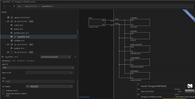

  • Hi Naeem,
    I'm using SDK v2.4.0 clean installation.
    Where is the .config file/directory? I can't find it.
    How do I check the compile DTS?
    Best Regards,
    JP
  • Hello Jose,
    You can check .config file in the /build/zephyr/ folder as shown below:
    You can also check the compiled DTS from the NRF Connect Extension on the left (bottom) in VS Code
    compiled DTS is also present in the /build/zephyr/ folder with name zephyr.dts
    Naeem
