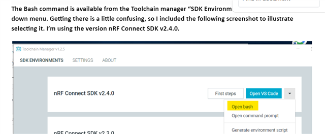

    I'm now using the bash command line tool accessible from the SDK version tab in the Tool Manger.

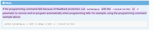

  • Hi Stephen,
    In the link I have mentioned in the previous comment, it highlights to this:
    Have you tried this?
    -Priyanka
  • Yes I have tried this. but a get the following error all the time?
    buildprog.py: error: unrecognized arguments: --recover-on-fail
    It appears that It doesn't know about the argument " --recover-on-fail"
  • The App doc page is incorrect the program command has an incorrect argument “--recover-on-fail”! It should be defined with underscores not dashes.
    THIS NEEDS TO BE FIXED ON THE DOC PAGE TO STOP CONFUSION WHEN USING THE AUDIO EXAMPLE TO BUILD & PROGRAM the KIT
    Using the command:
    python buildprog.py -c both -b debug -d both -p --recover_on_fail
