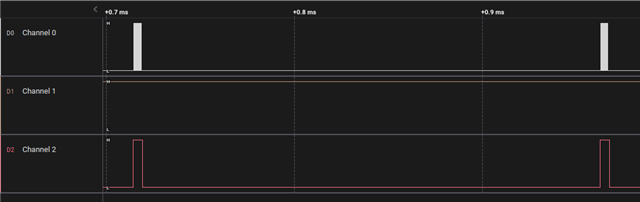

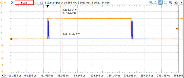

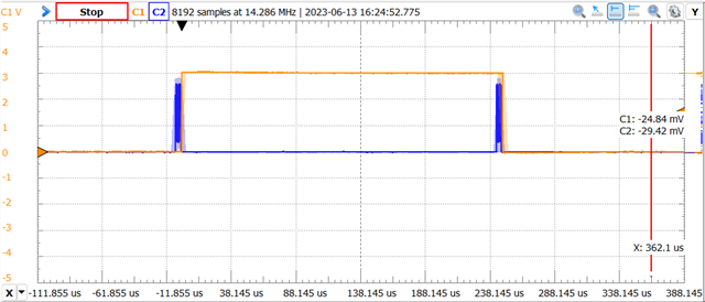

EXPECTED RESULT: CS(orange) toggle high right before SPIM START(blue), and CS toggle low once SPIM END.
ACTUAL RESULT: CS(orange) toggle high right after SPIM START(blue), and CS did not toggle low on SPIM END. Seemed like CS toggle happened only on SPIM END.

ACTUAL RESULT 2: CS toggle high before SPIM START, and still CS did not toggle low on SPIM END. Seemed like CS toggle happened only on SPIM START.
I checked with LED and confirmed SPIM END event happened. LED was blinking as expected.

Also, image below shows a happy case where MOSI(blue) gets triggered while CS(orange) gets triggered (4-wire mode ADC).
but we found in our case, MOSI stayed low all the time.

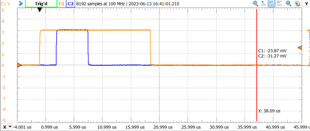

    Based on the scope pictures, it looks like the CSN task is called only on the END event, not the start event. There seems to be code missing, for instance for enabling and allocating etc. Have you looked at other samples that uses the nrfx_gppi API?
    -- I compared two samples you mentioned with my code, and I didn't find a significant difference. I am attaching my code here.

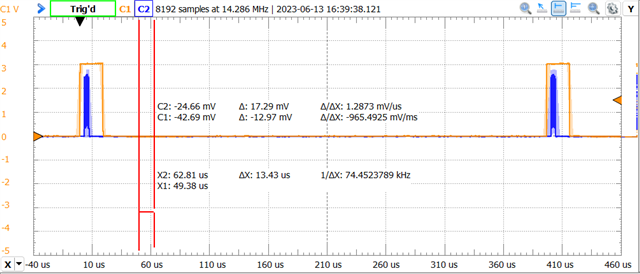

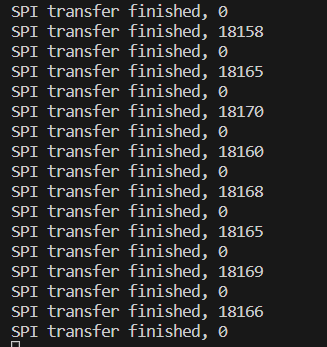

    The problem I am getting is the Slave Select line not toggling correctly so we end up only getting every other sample.
    Q. Even though we are getting every other sample, MOSI stays low all the time. Do you think this could be related to our SS-not-toggle problem?
    I am not familiar with this sensor. Have you tried asking the manufacturer about this?
    You are not setting the TX buffer, only RX. if you set both to be equal (ie. send 2, receive 2) you can define the TX buffer as you'd like.
    Håkon
  • This has solved my problem! Thank you so much!
