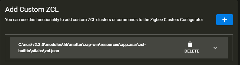

Development matter lock: After modifying the zap file, an error occurred when generating C++ source code
use nrfConnectSDK v2.3.0:
cheng@gavin MINGW64 /d/ncs/v2.3.0/modules/lib/matter ((v2.3.0))
$ python ./scripts/tools/zap/generate.py ../../../../igloo/matter_module_only_x1/lock/src/lock.zap
Searching for zcl file from D:\ncs\v2.3.0\modules\lib\matter\../../../../igloo/matter_module_only_x1/lock/src/lock.zap
Error: C:\tools\zap\zap-win\resources\app.asar\zcl-builtin\silabs\zcl.json does not exists or is not a file.
$ python ./scripts/tools/zap/generate.py ../../../../igloo/matter_module_only_x1/lock/src/lock.zap -t src/app/zap-templates/app-templates.json -o ../../../igloo/matter_module_only_x1/lock/src/zap-generated

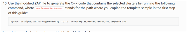

tips:
1.open: Adding clusters to Matter application — nRF Connect SDK 2.3.0 documentation (nordicsemi.com)
2.Browse to: Use the modified ZAP file to generate the C++ code that contains the selected clusters by running the following command, where samples/matter/sensor stands for the path where you copied the template sample in the first step of this guide:
    The Zap tool is created with Linux in mind so it might not be perfectly compatible with Windows, and there might be errors in the paths such as the one you observe. Specifically what error occurs is when the tool expects a linux based location with /, while Windows expects \.
    If you change the path of the file mentioned in the error to"path": "../../../../../modules/lib/matter/src/app/zap-templates/zcl/zcl.json" (or the slashes the other way around depending on what the OS you're usingexpects), it should work.

    Here I should mentioned that "Add custom ZCL" window showed me zcl.json file in the similar path as it is in your picture ".../app.asar/zcl-builtin/silabs/zcl.json"

  • It seems that I fix it. The problem was in output ZAP file. In my case: light_bulb.2.1.zap. The file contains the section:
      "package": [
          "pathRelativity": "relativeToZap",
          "path": "../../../../../nordic-4.1.2/v2.4.1/modules/lib/matter/zap/zap-linux/resources/app.asar/zcl-builtin/silabs/zcl.json",
          "type": "zcl-properties",
          "category": "zigbee",
          "version": 1,
          "description": "ZigbeePro test data"
    but the input ZAP file ( light_bulb.zap) contains the section:
      "package": [
          "path": "../../../../../modules/lib/matter/src/app/zap-templates/zcl/zcl.json",
          "category": "matter",
          "version": 1,
          "description": "Matter SDK ZCL data"
          "path": "../../../../../modules/lib/matter/src/app/zap-templates/app-templates.json",
          "type": "gen-templates-json",
          "version": "chip-v1"
    Unfortunately, it is still wrong but it is a bit closer. The right section should contains the updated paths:
      "package": [
          "path": "../../../../../nordic-4.1.2/v2.4.1/modules/lib/matter/src/app/zap-templates/zcl/zcl.json",
          "version": 1,
          "path": "../../../../../nordic-4.1.2/v2.4.1/modules/lib/matter/src/app/zap-templates/app-templates.json",
    Now, it is possible to generate c/cpp code from ZAP file. When I solved it, I immediately faced to another problem with ZAP tool with following steps:

  • Aha, ZAP tool obtains paths to JSON files from ZAP file. Thus the correct procedure is following:
    - update paths in light_bulb.zap
    - open input file: light_bulb.zap in ZAP tool
    - no modification
    - save output file: light_bulb.1.zap in ZAP tool
    Finally, files light_bulb.zap and light_bulb.1.zap will have the same size 257.7kB
