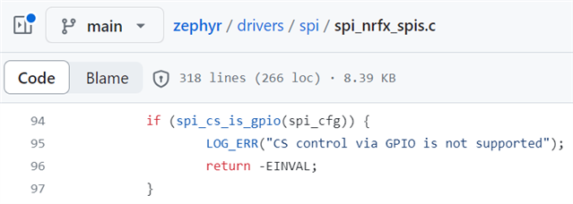

  • Ok, I have the log information now going.  The -EINVAL is from this error message:   spi_nrfx_spis: CS control via GPIO is not supported
    I am assuming at this point that something in my overlay is not quite right with regards to the CS definition.  This information should be in the previous post.
    Thanks in advance for any thoughts.
    -Keith
  • As I understand this now, the SPI Slave code does not support monitoring a GPIO line assigned as a CS control line.  This is still a bit opaque from the zephyr and other documentation.
    Passing a NULL value into spi_cfg.cs allows the spi_transceive_cb to be called without an immediate error being thrown.
    I'm in the process of manually checking for the state of a cs line and should have some more code ready test later today.
    Does anyone know if there is a decent write-up on the SPI support software and its functionality for NRF running zephyr?

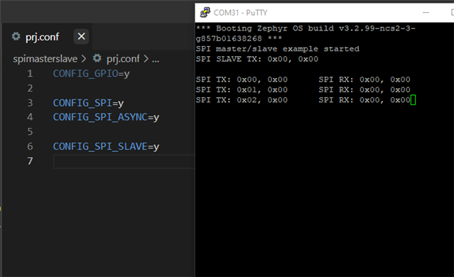

  • espian said:
    As soon as I modify the proj.conf file so that I can see the printk output, I start having issues.
    I am not sure why such is happening.
    can you send your minimal project, just enough to show what you are facing. Please strip it down to minimal version just to show the functionality and error.

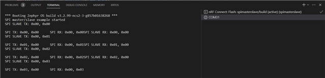

  • My last set of comments were with the GitHub master slave code with the only change being 1) changing several of the printk's to printf's and 2) the above changes to the proj.conf file.
  • espian said:
    I get a toggling LED, as expected from the code.  However, I can not see any of the printk messages.
    I am using the same sample for 52840DK and I can see the messages on console (printing both messages on the same line).
    What do you mean by this? printk() is zephyr kernel function, and is supposed to be used with ncs/zephyr for console messages.
    It is also important that you connect to the correct serial port.

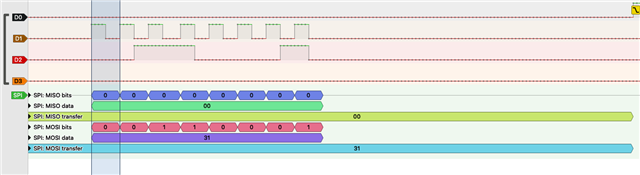

  • I'm quite sure that the sample code is running properly.  However, I'm not going to see the UART output.
    I'm using a Fanstel eval kit (which is almost a carbon copy of the NRF52840DK), however the Fanstel module that is mounted on my board (BT840X) does not expose UART0 because it uses that on-module to control a PA.  This was very non-obvious and only mentioned in one line in their data sheet.
    I'm going to go back up in this thread to the actual issue/question as my CB is never being called.  I'll post more code related to that soon.

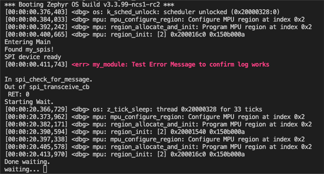

  • I did fix a couple of items in my original code.  However, the issue remains that the call back function is never called.  I have changed the buffer size up and down to check for impact there and nothing.  It doesn't seem to matter if I underflow, overflow, or perfectly match the buffer size with the spi incoming data, the cb is never called.
    I'm still not clear as to what triggers the 'end' of an spi transaction in the driver and I suspect that is the fundamental issue that I'm having.
    I've included everything that I can think of below.  The GPIO registers, the code properly waits for the cs line to go active (low) and then beings the spi call back setup, pauses and then waits.
    Thanks for having a look.

    Here is a copy of the console output:
    Here is a screen shot of the logic analyzer capture feeding the dk:

  • Hi Keith,
    Sorry for the delayed response
    I am note able to reproduce the issue that you are having.
    Are you able to compile and run the sample correctly?
    Can you send a complete zip folder which I could build for nrf52840dk to reproduce the error you are having?

    espian said:
    If you are referring to the sample master-slave code example, I had posted that it was, in fact, operating properly, and that I was returning to dealing with the initial issues that I had posted about.
    Yes, I was referring to the sample code (master/slave) and use with the DK.
    I did not test with your code, or with other boards.
    espian said:
    I actually just found a major reason for it,
    Good that you that you found the issue.
    BR
  • Since there are a number of people subscribed to this ticket, I will document this issue and what fixed it.  Then wrap up with some other comments.
    The first two things that caused me issues were that the SPI samples I was finding were using the GPIOS definitions for the CS line.  In SPIS, that is not allowed.  Tracing back the -EINVAL error (and properly enabling the logged message) was the trick to figuring out this first step.  (You can see the result of this and the 'fix' above).
    Once past this hurdle, I had mentioned multiple times that there seemed to be something that I was fundamentally missing on understanding what within SPIS actually terminated an SPI message.  There is so much abstraction and so much that is 'automagically' done within the NRFSDK and Zephyr code bases, it is very difficult to know sometimes when you need to sit back and let the code-base do something for you and when you're required to handle something for yourself.  To be clear, I'm not an embedded newbie.  I have used SPI in designs starting in the early 1990's, so am pretty well versed in the hardware and typical software to support it.  Again, my issues here were largely around the things that were abstracted away and controlled by the software libraries and how they worked.
    I finally found in the Zephyr discord channel a mention that when using SPIS the driver expects to use the hardware CS line embedded in the SPI transceiver hardware and a follow-up mention of "don't forget to set your pinctrl's".
    In the overlay, I added
    <NRF_PSEL(SPIS_CSN, 0, 29)>
    to
    &spi1_default {
    group1 {
    psels = <NRF_PSEL(SPIS_SCK, 0, 31)>,
    <NRF_PSEL(SPIS_MOSI, 0, 30)>,
    <NRF_PSEL(SPIS_CSN, 0, 29)>,
    <NRF_PSEL(SPIS_MISO, 1, 8)>;
    And almost immediately my code started working.  Simply the CS line was not 'connected' to the code and as such the end of message was never being triggered because it relies on the hardware CSN line to detect that state.  I'm still not sure where in the codebase this is setup/controlled.  I'm quite sure I would struggle to find it partially due to the lack of comments in the code.
