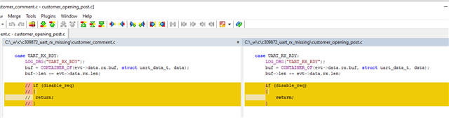

  • Hi Theja,
    The code you give in the opening post and in your later comment are different in a key part
    Which is the correct one?

  • Hi Hieu,
    Sorry for that bumble, Uncommented one is the right one.
