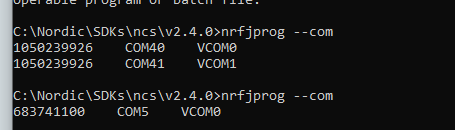

    Rev 3.0.x of the nRF52840DK has 2 comports, but only one of them is 'available to the user'. Could you try to list the available ports with nrfjprog --com and try with the other one? It should be TTYACM0 or TTYACM2 instead of TTYACM1 which you've tried.
    Here's how it looks on windows: The one on top is a rev. 3.0.0 version of the nRF52840DK, the bottom one is in this case a rev 1.0.0, but it should showcase the same as a rev. 2.0.0
