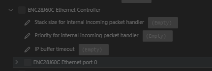

I tried to enable ENC28J60 on KConfig but it seems to be locked in some way and it's impossible to me to enable the Ethernet Controller
So, what's the way to enable it, to have an overlay file that make my project compile and unlock this situation?

    There has been changes to how pins are defined in nRF Connect SDK over the years. The main difference is the introduction of Pin Control. Which nRF Connect SDK version are you using now?
    I'm trying to use a ENC28J60 shield on a nRF52480DK.
    Exactly which board/shield are you using? Could you please provide a link or some documentation? You could borrow from the shield MikroElektronika ETH Click and add SPI configurations in accordance with the the new Pin Control style. I will try to set up an example.
