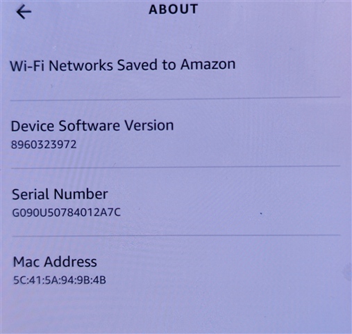

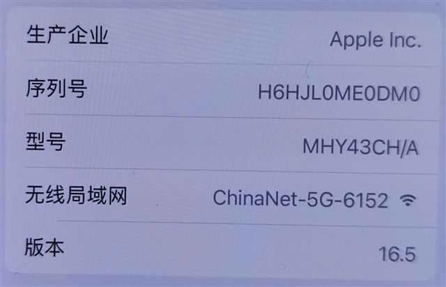

      Thank you for your answer.Below is my version of Apple HomePod and echo dot3. In both cases, the HomePod can be reconnected to the development board. The Echo dot3 case is as described above.Looking forward to your reply.

    I read your original text as after power cycling the DK it can reconnect to the Amazon Echo but not the Apple HomePod mini, and after power cycling the Echo the DK cannot reconnect. If I understand you correctly now, the issue is only with power cycling the Echo?
