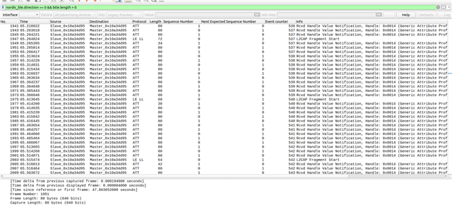

    MTU size is 158
    The actual connection parameters are negotiated between the central and peripheral after the connection is established, and we don't know what the RADIO packet length is here. You can use the nRF Sniffer for Bluetooth LE to see how many packets are sent per connection event if you have an extra nRF52840 Dongle or DK laying around.
