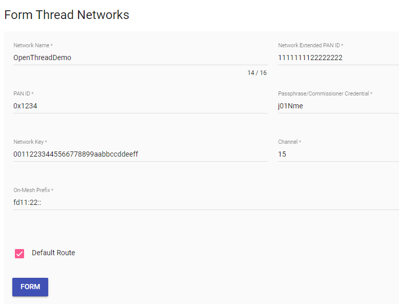

The PC using Ubuntu OS(with nRF52840 dongle) is configured as the OTA provider and the nRF52840DK board is configured as the OTA requester.
I completed the installation of ota-provider-app and chip-tool on the Linux PC and commissioned the Linux PC as an OTA provider through the command below
./out/chiptool/chip-tool pairing onnetwork 1 20202021
And after configuring the new thread network through OTBR, nRF52840DK board was commissioned with node ID 2.
./out/chiptool/chip-tool pairing ble-thread 2 hex:0e08000000000001000035060004001fffe00708fdb96028cd2611df0c0402a0f7f8051000112233445566778899aabbccddeeff030

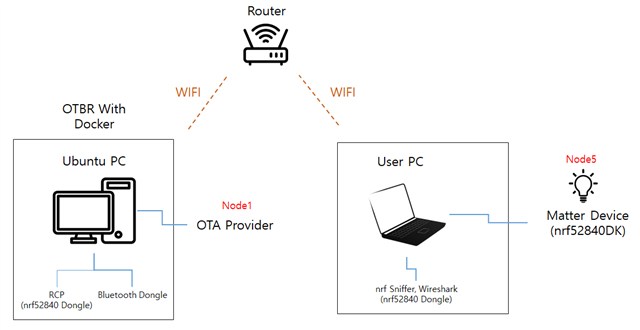

    What are you running the OTBR on, and are you running it in docker mode or manually?
    Are you able to communicate with both the nRF52840 DK and OTA provider on the Matter network, and is the computer with the OTA provider on the same Wi-Fi network as the OTBR?
    Marte
  • Yes, OTBR is running in docker mode and has been confirmed to communicate with the nRF52840DK with the Led onoff toggle command. They are all on the same WIFI network.
    <OTA provider>                                         <OTA Requestor>
    | PC(ubuntu)             |                              | nRF52840DK        |
    | nRF52840 Dongle  |          <----->
    It has also been confirmed that both Node1 (OTA provider) and Node2 (OTA requester) work using Chip tool on Linux PCs (read Vender id or Product id...etc)

    4. OTA announce
    (I entered the command below through another terminal.
    sudo ./out/chiptool/chip-tool otasoftwareupdaterequestor announce-otaprovider 5 0 0 0 10 0)
    OTA target nRF52840DK board shows the same error log as above, but no response from OTA Provider (no log output)
    Additionally, in the current situation (OTA Provider with Node 5 and Matter Device with Node 10, nrf52840DK) are both
    Respond to the chip tool command below.
    (The OTA Provider does not operate because there is no cluster at its end point, but the corresponding error log is output.)
    "sudo ./out/chiptool/chip-tool onoff toggle 5 1"
    "sudo ./out/chiptool/chip-tool onoff toggle 10 1"
    This makes it appear that both OTA Provider and Matter Device are connected to OTBR.
    (Conversely, the Unpair command works too!)
    And I found the guide below through YouTube, and it was confirmed that OTA works after configuring the environment in the same way!
    (In the guide, only OTA ProviderAPP and OTA Requestor are configured on one PC without Matter Device.)
    www.youtube.com/watch
    If it consists of only OTA ProviderAPP and OTA Requestor, it seems that OTA can be tested without OTBR. It this for real?
    I don't know how to check 802.15.4 Sniffer using WireShark....Disappointed relieved
    If you explain the part in detail again, I will let you know the results of the confirmation.
    Please reply if you need additional information. Slight smile

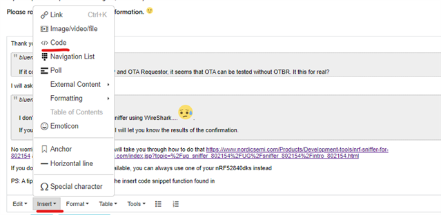

    No worries! Here's a couple of links that will take you through how to do that https://www.nordicsemi.com/Products/Development-tools/nrf-sniffer-for-802154 and https://infocenter.nordicsemi.com/index.jsp?topic=%2Fug_sniffer_802154%2FUG%2Fsniffer_802154%2Fintro_802154.html
    If you don't have a nRF52840 dongle available, you can always use one of your nRF52840dks instead
    PS: A tip for attaching the logs is to use the code snippet function found under insert to make the case more manageable to scroll through! :) I will go through your replies now and edit them into boxes for you but for future logs and attachment that will really improve readability of your case
