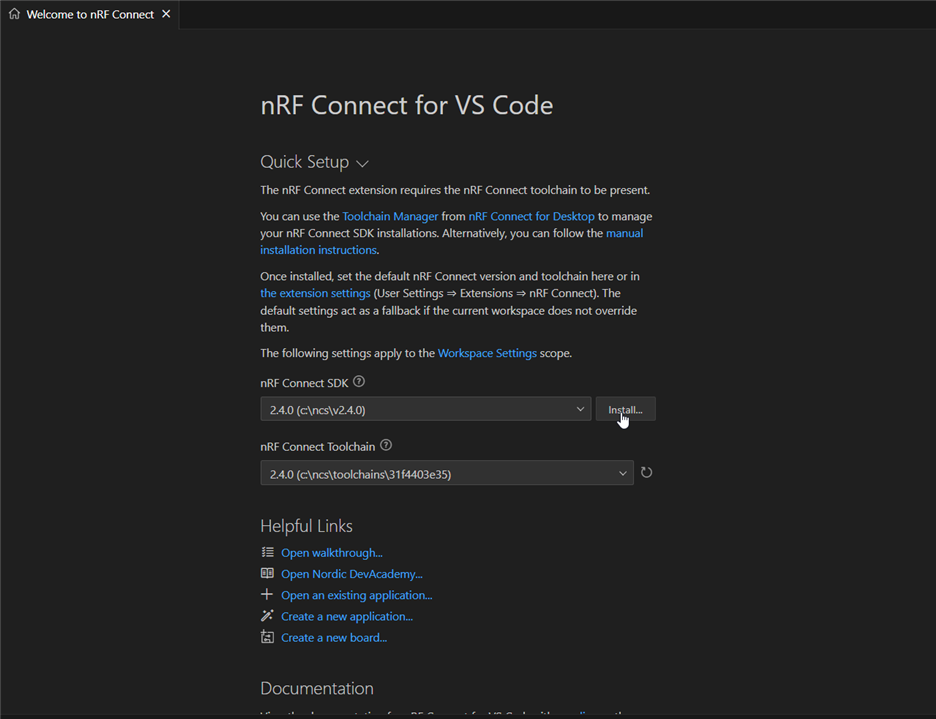

  • In the Welcome to nRF page (see picture) choosing the modded SDK folder by select browse and choose the modded SDK folder in folder ncs + choosing the modded toolchain folder in ncs -> toolchains

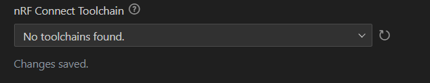

    • Browsing and choosing the modded toolchain folder though just gives “No toolchains found” so this has been without success (see picture). I do not know what effect this has.
    • Nonetheless I just tried using the standard v2.1.0 toolchain instead and it defaults to this anyway when choosing the modded SDK folder (picture).
    • When browsing and choosing the modded SDK folder (not the toolchain) named “v2.1.0_test” and everything seems fine but when closing and opening the Welcome Page again makes it obvious that the nRF Connect extension defaults back to the standard v2.1.0. An attempted build results in success but this is because the standard v2.1.0 was used and not the modded SDK.

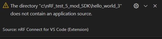

    • Just to try it, when creating an example application hello_world (picture) it just creates a folder in the directory without files and does not build anything. Of course if I try to open the application in this directory no application is found since none was created except the directory (picture).

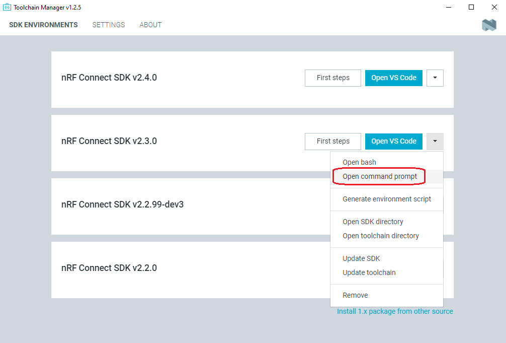

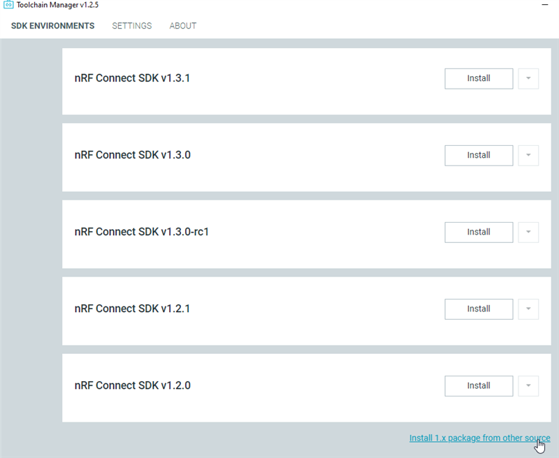

  • I tried using Toolchain manager to install the modded SDK: In the Welcome to nRF page (see picture) selecting install -> open toolchain manager -> scroll down -> “Install 1.x package from other source” (picture) -> Select file (picture) -> ?

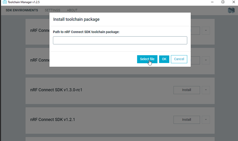

    • What file is meant to be selected here? Sorry if this is a dumb question but I can’t find any suitable file that I am able to select. It asks for a package-type file in explorer.
