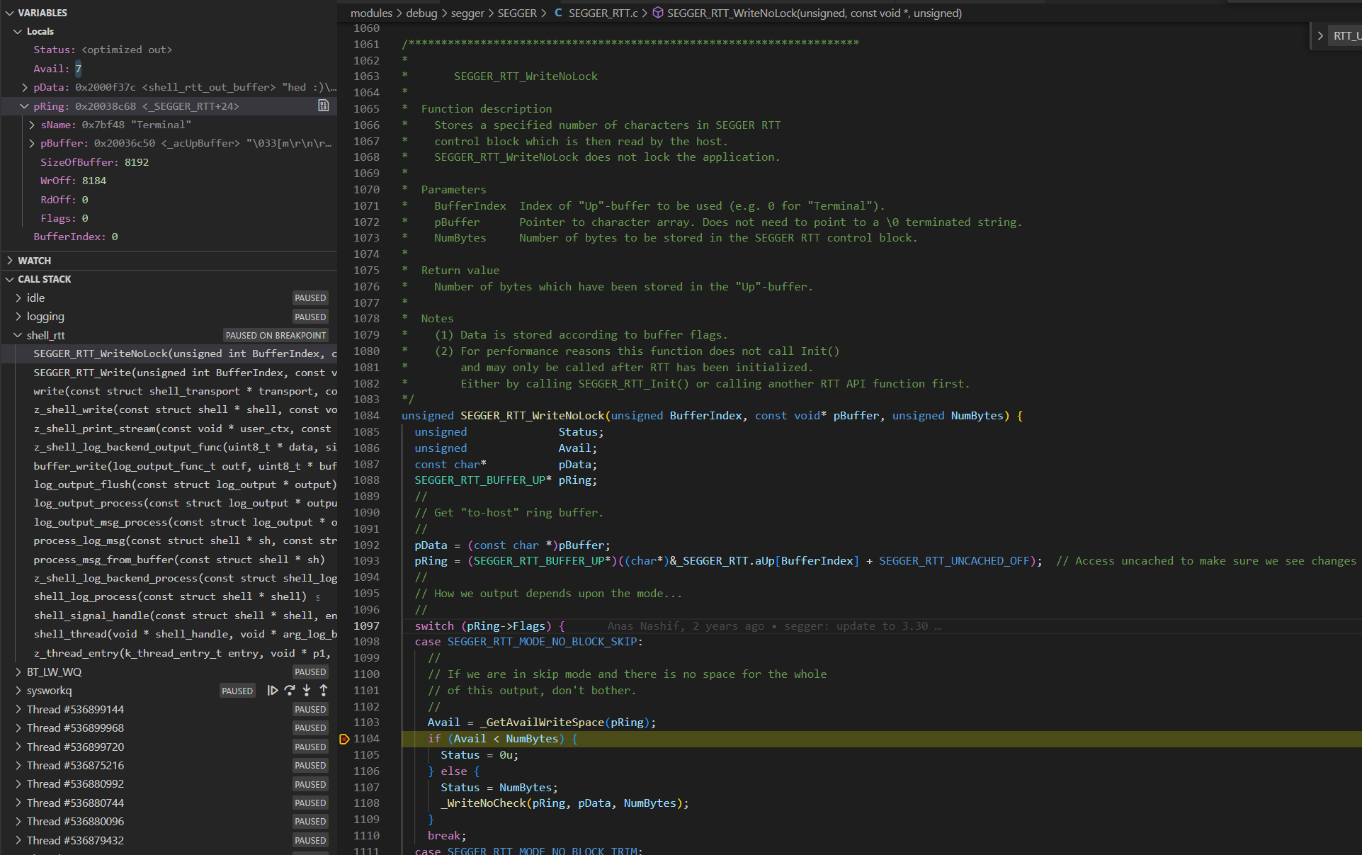

  • Hi again, I have some discoveries done during a debug session using VSCode.
    Long story shot: it seems like the Segger's RTT buffers get filled, so it gets stuck waiting for them to be emtpy (which does not happen ever).
    This is the infinite loop, inside z_shell_write()
    z_shell_write
    The variable lenght should be reduced by steps of size tmp_cnt but that value is always zero.

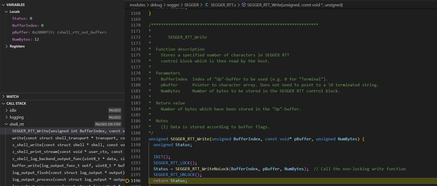

    tmp_cnt content is updated on shell_rtt.c 's write():
    shell_rtt_write
    Since rtt_blocking = false, SEGGER_RTT_Write() is called on the else statement:
    Finally, on SEGGER_RTT_WriteNoLock() what happens is that, since we don't have available space (our buffer of size 8192 has only 7 free bytes), we return 0:
    It seems like the setting CONFIG_SEGGER_RTT_MODE_NO_BLOCK_SKIP=y is not working, or it does not work like I would expect (just discard unsent bytes). Is there anything I can do in order to force flushing the buffers? I think that should do the trick.
    Thank you for the impressive debug work you've done!
    I created a hello_world with RTT log and shell, to mimic the behavior. It behaves exactly as you describe, meaning that it is stuck in the shell_write function here:
    https://github.com/nrfconnect/sdk-zephyr/blob/v3.3.99-ncs1/subsys/shell/shell_ops.c#L403-L425
    Here's the minimal project I used to recreate the issue, where I placed all threads on the same priority:
    hello_world_shell_rtt.zip
    I've used the gpio's P0.28/P0.29 to indicate if the main/blink threads are running, and when the RTT buffer is filled up; it completely dies due to the shell subsys running in a loop.
    Disabling shell via CONFIG_SHELL=n will cause the threads to run as expected.
    I will report this internally as a bug in the shell subsys.

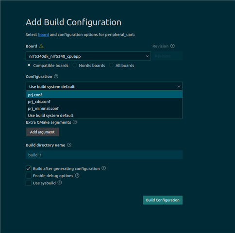

    Mi question is: How can we handle multiple prj.conf files in order to support multiple configurations? I'm aware of how specify overlays, but no configuration files.
    Thanks!
    It depends a bit on what you have, and what you want.
    First option is to have a full prj-debug.conf / prj-release.conf, and the second is to use a common prj.conf file and add functionality on top, for instance, overlay-debug.conf/overlay-bootloader.conf etc.
    If you are using vscode, you can select the appropriate .conf file, as well as add a kconfig fragment:
    Alternatively, you can do this with west.
    To point to a new prj config (ie. a overwrite):
    west build ... -- -DCONF_FILE=prj-release.conf
    To append an already present prj.conf, you can do this to add specific kconfig entries on top:
    west build ... -- -DOVERLAY_CONFIG=overlay-debug.conf
