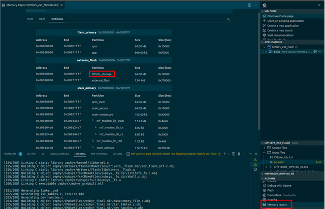

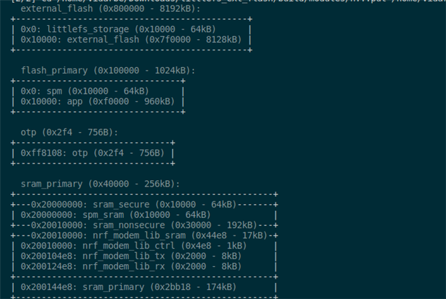

  • Hello Ben,
    The external flash region gets added when you have set the 'pm-ext-flash' property, as explained in the External Flash of the partition manager documentation. However, it does not automatically place the littlefs partition within it. We added the CONFIG_PM_PARTITION_REGION_LITTLEFS_EXTERNAL symbol in v2.1.0 to allow the partition to be added automatically.
    For v1.7.1, you need to define the partition yourself. You can do this by creating a file named 'pm_static.yml' that contains the following:
    littlefs_storage:
      region: external_flash
      address: 0x0
    external_flash:
      address: 0x10000
      device: MX25R64
    Then place the file in your project directory so it gets picked up by the build system (Static Configuration).
    Tip: you can use the "Memory report" button in VS code if you want to view the memory layout, or "$ west build -t partition_manager_report" if you are building from the command line.
    Vidar
