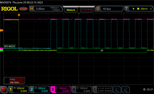

The bus seems to work fine for a small amount of time. I can write maybe 500kbit to the SD card or can start to configure the wifi module, but after a small amount of traffic the bus seems to have a hiccup and stops working, In the case of the SD card I get a file write error, and with the wifi module it just stops sending the correct next command to continue configuration.
Troubleshooting

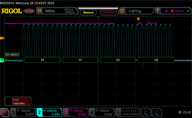

I have scoped the lines at 8, 16, and 32Mhz and they have essentially identical form. It does not seem to be raw signal related. I know the devices can work at 8Mhz because they work fine when using SPIM2. I tried using SPIM3 at 8Mhz and even down to 4Mhz and get the exact same behavior. So again, that leads me to believe that the issue is not speed or signal related, but that is just an assumption on my part.
I also printed all of the spi traffic from the wifi module to see where things start to differ. It always differs at the exact same spot in configuration. It makes an 2 byte transmit and expects a 2 byte response of 0x00 0x58. I get the correct response when using SPIM2, but on SPIM3 it always responds with 0x00 0xb0. It may be a coincidence, but 0x58 left-bit-shifted by 1 is equal to 0xb0 so it may be that the RX value is being shifted to the left by one. (0x58 = 01011000; 0xb0 = 1011000).

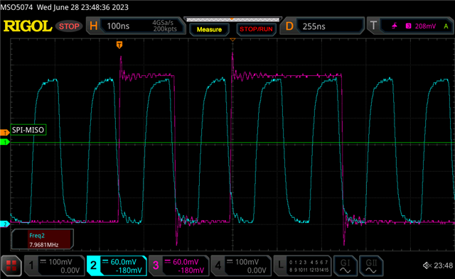

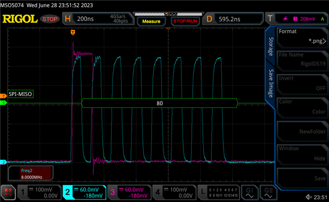

  • I had skipped checking that, but it appears I was lucky and was in the correct mode. NRF_SPIM3->CONFIG reports as 0 and the chip I have operates in mode 0 (CPHA = CPOL = 0) and the MSB is shifted first.
    Also, I know I had mentioned that I had scoped the signals, but I went a bit further and was actually decoding the MISO line and validated that while the chip's software was reporting a bit-shifted value (only after a certain point), the scope decoding was reading the correct values and the scope was also configured to use SPI mode 0.
  • With the screenshots above I see "working" is indeed Mode 0, shift on negative edge and sample on positive edge; however when it's "not working" the shift is occurring on the positive edge which implies either that the 'scope is showing traces from two different devices which have different Modes or that the device was inadvertently changed to use a different Mode.
    If two different devices with different modes just change the Mode prior to accessing each device.
  • Yeah, I agree with you here. I'll double check to see what the mode for the other device is. I am however checking the NRF_SPIM3->CONFIG register on each transaction and it's always reporting as 0 which I was interpreting as the mode not changing. My understanding is that the mode is set through the spi_config struct by assigning the CPOL and CPHA values.

  • It's the slave on the "Not Working" device that is not in Mode 0, not the Master .. try changing the Mode on the Master just before accessing that fail case and all should be well
  • You should ideally measure both CLK, MISO and MOSI here.
    It's only the MOSI that can show/confirm the correct mode is used every time by the SPI master, the MISO however is fully controlled by the slave device, and if MISO randomly change mode or polarity, then it's more likely a pin floating here somewhere that potentially cause the slave to change mode of operation than what you configure the SPI mode of the master.
    Kenneth
