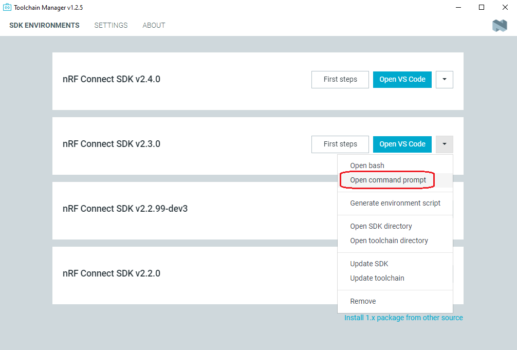

    I don't see any immediate issues with the code or configurations you posted. It would be helpful to know where the bus fault was raised. You can use the 'addr2line' from the command line to look up the 'Faulting instruction address'.
    e.g.
    /* zephyr.elf is found in <build folder>/zephyr */
    $ ncs/toolchains/v2.3.0/opt/zephyr-sdk/arm-zephyr-eabi/bin/arm-zephyr-eabi-addr2line -e zephyr.elf 0x00011ac8
    Vidar

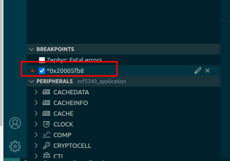

  • 'addr2line' is a command-line tool that converts input addresses to file names and line numbers. It is included as part of the toolchain. To run it, open the command prompt via the toolchain manager and type 'arm-zephyr-eabi-addr2line -e <your application>.elf <address input>.
    Another approach is to set a breakpoint at the faulting address in your debugger and see where your program halts when the breakpoint is reached.
    Here's how you can set a breakpoint at an arbitrary address in VS Code
    Debugging of busfaults is not covered by the SDK documentation.
