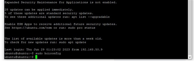

  • Hi.
    Can you try the following:
    1. Check if you can find the Bluetooth CHI adapter by using the command "hciconfig"
    2. In Chip-tool you can select the adapter you want to use by the param "--ble-adapter"   e.g.
    ./chip-tool pairing ble-thread 1 hex:xxxxxxx 20202021 3840 --ble-adapter 1
    Customer may restart bluetooth service
    sudo service bluetooth restart
    or reset HCI interface e.g.:
    sudo hciconfig hci1 reset
    And if that is not helping you can try a USB BLE adapter instead of the built in
    Regards
    Runar
  • Hi Runsiv
    1. hciconfig found nothing at My Pi. It's weird.
    I tried two ways to install OTBR/CHIP-TOOL. Below was what I did. hciconfig found nothing for both ways. Anything wrong?

    I don't think this has anything to do with how OBTR/CHIP-Tool was installed. We need to get the BT working first.
    Is it Raspbian you are running?
    Did you do a restart or tried to start the Bluetooth service waster you installed pi-Bluetooth?
    You can also try to run:
    hciconfig --all
    To include disabled devices.
    Can you also verify is the following packages are installed by just trying to reinstall them
    sudo apt install bluetooth pi-bluetooth bluez blueman
