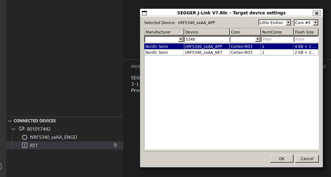

On Monday I started my VSCode workspace as usual (Running on a WSL2 instance), and a popup notifying that the new version for nRF Connect plugin was installed. Everything looked good (building/and flashing), but when iWanted to start an RTT session for my nRF5340 board, the following message appeared:
jlink - device selection
After clicking OK, a prompt for selecting the device shows up. I can search for nrf5340 device in there:
target-device-settings
Selecting nRF5340_xxAA_APP made the RTT session available, so I could see log messages and use the shell as usual.
Fortunately this workaround exists, but is a little bit annoying to search for the device every time I want to connect (which is very frequent).
