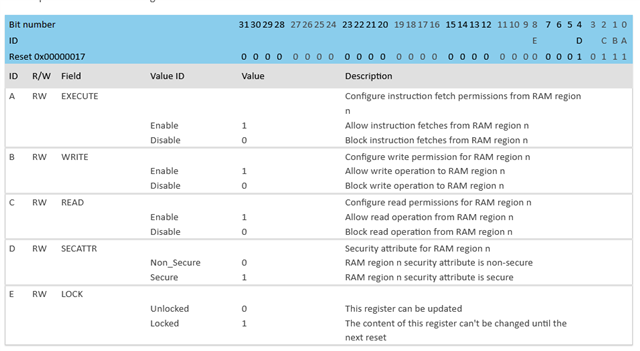

    I think that the SPU does not have to depend on domains. From https://infocenter.nordicsemi.com/topic/ps_nrf5340/spu.html?cp=4_0_0_6_31_8_21#register.RAMREGION.PERM:
    So the Secure/Non-secure attribute is separate from the Write attribute.
    Therefore, I think you can use this for only Write protect.
    By the way, If you build without TF-M, the whole application runs as "Secure" from the SPUs perspective.
    And when using the SPU, how would I then write to the protected memory? Simply temporarily disable the protection?
