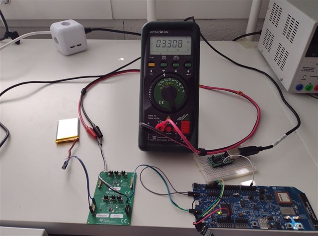

with the help of the devzone community I configured the overlay to use the uart2 for the zehyr console. The aurt2 TX is on the pin 0.24. This pin is then connected to the UART-to-USB converter UM232R USB, where it then goes to the PC. When I power the nrf9160 DK via USB (J6), everything works. The serial terminal works as it should. I get this output:
*** Booting Zephyr OS build v3.3.99-ncs1 ***
[00:00:00.303,802] <inf> aero_sens: Start v.4, baord: nrf9160dk_nrf9160
[00:00:00.544,921] <inf> nrf_modem_lib_trace: Trace thread ready
[00:00:00.546,539] <inf> nrf_modem_lib_trace: Trace level override: 2
However, when I connect the nrf9160 DK to the battery at P21, I get nothing on the serial port. I add the picture so that everyone understands.
The LED of the debugger only blinks in a quite high frequency. My setup is as follows: I have a 1500 mAh 3.7 battery that I connect to a TI TPS62840 step-down converter (green board) that gives me 3.3V. With this I then go to the P21. I also measured the output voltage of the converter and it looks good:
What am I missing?
