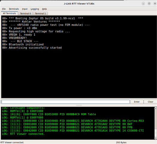

I am trying to achieve +3dBm Tx power using VREQCTRL on the network core. I am currently executing the hex on normal voltage mode. I am unable to distinguish the power levels between 0 dBm and +3 dBm hexes using RSSI viewer on nRF connect app (iOS) (values at specific distances are more or less identical).
I have the following questions:
Power supply questions:
  • Is a normal voltage mode, capped at 1.8V supply voltage (VDD) sufficient?
  • Does VREGRADIO powering the network core internally does a DC/DC voltage boost on VREQH request.
  • I also found a graph (attached) suggested 1.8V supply is sufficient for +3 dBm. Please confirm correctness.
Testing questions:
  • The RSSI viewer (on nRF Connect App using an iPhone) shows -12 to -16 dBm for both 0 and +3 dBm firmwares which is the cause of contention.
    • Is this a correct observation?
    • How accurate are the RSSI viewers?
    • Does the hardware running (in this case iPhone) makes a difference?
    • Does the environment (we didn't test in a special chamber) make a difference?
  • Will a spectrum analyzer help with this issue or will it have the same observations?
Thanks !
Attached:
  • Source code
  • RTT observation
  • Graph for +3 dBm

  • Hi
    The RSSI viewer is not very reliable, so it's not the best tool for measuring radio sensitivity/gain. You should be able to see the difference better at longer ranges in a noise free environment as well, as the extra dBm won't do much to the RSSI on a cm basis. But to properly review the difference between the TX power, I'd recommend using a spectrum analyzer, however they are not cheap as far as I know.
    So to sum up:
      • Is this a correct observation? Yes
      • How accurate are the RSSI viewers? Not very, especially at very close distances
      • Does the hardware running (in this case iPhone) makes a difference? Yes, as the radio on the phone is used for receiving the signals
      • Does the environment (we didn't test in a special chamber) make a difference? Yes, we recommend testing sensitivity in a noise free environment for the best possible results
    • Will a spectrum analyzer help with this issue or will it have the same observations? A spectrum analyzer should help
    Simon
