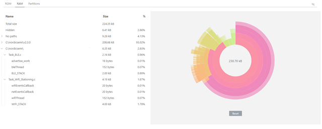

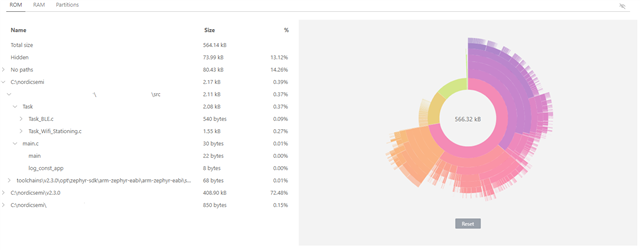

Is there any option to reduce the project's size? I have already disabled the debug options.

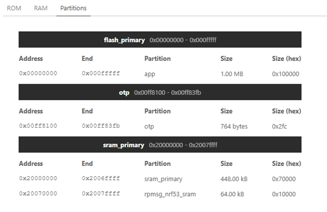

  • In your log, I see multiple warnings like this:
    warning: NORDIC_QSPI_NOR (defined at C:/nordicsemi/v2.3.0/nrf/Kconfig.nrf:97,
    drivers/flash/Kconfig.nordic_qspi_nor:4) was assigned the value 'y' but got the value 'n'. See
    http://docs.zephyrproject.org/latest/kconfig.html#CONFIG_NORDIC_QSPI_NOR and/or look up
    NORDIC_QSPI_NOR in the menuconfig/guiconfig interface. The Application Development Primer, Setting
    Configuration Values, and Kconfig - Tips and Best Practices sections of the manual might be helpful
    too.
    I suggest that you look into fixing these first.
    You can do this by running "ninja menuconfig" inside "build/" or inside "build/mcuboot", depending on which image has the warning.
    Candela said:
    think it has to do with the XIP address warning
    Do you try to use XIP in your project?
