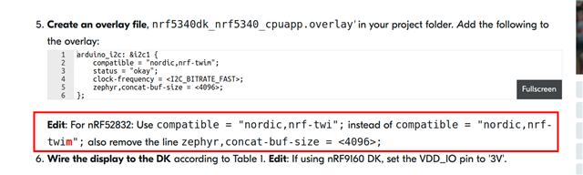

I use ncs V2.3.0 with NRF52832 on my own board ,not 52832dk board.   I connect one oled(ssd1306 with pixels of 64*32) by i2c1.
when I run my test code, I got the question like this:
