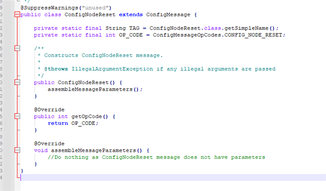

  • We are using BLE DFU one by one using tablet/phone. Unfortunately the devices where this problem showed up are at the clients location so we were not able to capture logs from them or try to reflash them using the debugger. After the bt_mesh_reset(), yes we did a manual reboot. The devices then started advertising and were able to be provisioned again. After many DFU cycles we were not able to reproduce the issue in our office. We are using external flash and I verified the provision information is still stored after a DFU cycle. Our latest assumption is that the device did not un-provision successfully which likely caused this issue. Can you please outline the steps the mobile takes to un-provision/delete a mesh device? Are there many calls in Android to complete this process and why do you think this might have failed?
  • Hi Terry,
    You can look at the app source code to find that it simply send one single CONFIG_NODE_RESET opcode to reset the node:
    https://github.com/NordicSemiconductor/Android-nRF-Mesh-Library/blob/main/app/src/main/java/no/nordicsemi/android/nrfmesh/node/NodeConfigurationActivity.java#L271
    Here is what inside ConfigNodeReset.java
    What I concern of is if you have wait untilbt_mesh_reset() has finished the flash operation before you reset.
    If you look at the code of the new mesh DFU sample you can find this:
    https://github.com/nrfconnect/sdk-nrf/blob/main/samples/bluetooth/mesh/dfu/common/src/dfu_target.c#L205
    It wait for  1ms before it execute the reset command.
    Could you tell us the sequence on how you do DFU and reset the node ?
    I think you may need to recall the defect unit and check the log if any or step into the code to see where it crashed.
