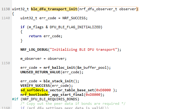

  • what we did was is
    1.Created one ble_blinky example with start address = 0xd8000 size 0xA000.
    2.Changed the secure bootloader accroding to what you mention in the link.
    3.combined these two hex files with soft device hex (using mergehex tool) and then flashed on the dev kit but it didn't booted.

  • Hi Akshay,
    Please show exactly what you did in step 2. Use Insert -> Code when you want to add code to your answer.
    Please make sure you managed to step into the code of the bootloader for debugging. You need to compile the bootloader in debug mode (no optimization , use the debug variant). You are doing something quite advanced so you need to study the bootloader code and know how to debug it.
    With my solution what you need to do is to initialize softdevice, after that call sd_softdevice_vector_table_base_set(0xD8000 ) then call nrf_bootloader_app_start_final(0xD8000). You can try adding it to ble_dfu_transport_init() just for the shake of testing:
  • i called here
    ret_code_t nrf_bootloader_init(nrf_dfu_observer_t observer)
    NRF_LOG_DEBUG("In nrf_bootloader_init");
    ret_code_t ret_val;
    nrf_bootloader_fw_activation_result_t activation_result;
    uint32_t initial_timeout;
    bool dfu_enter = false;
    m_user_observer = observer;
    if (NRF_BL_DEBUG_PORT_DISABLE)
    nrf_bootloader_debug_port_disable();
    #if NRF_BL_DFU_ENTER_METHOD_BUTTON
    dfu_enter_button_init();
    ret_val = nrf_dfu_settings_init(false);
    if (ret_val != NRF_SUCCESS)
    return NRF_ERROR_INTERNAL;
    #if NRF_BL_DFU_ALLOW_UPDATE_FROM_APP
    // Postvalidate if DFU has signaled that update is ready.
    if (s_dfu_settings.bank_current == NRF_DFU_CURRENT_BANK_1)
    postvalidate();
    ble_stack_init();
    sd_softdevice_vector_table_base_set(0xD8000);
    nrf_bootloader_app_start_final(0xD8000);

    this is the error coming
    <info> app: Inside main
    <debug> app: In nrf_bootloader_init
    <debug> nrf_dfu_settings: Calling nrf_dfu_settings_init()...
    <debug> nrf_dfu_flash: Initializing nrf_fstorage_nvmc backend.
    <debug> nrf_dfu_settings: Using settings page.
    <debug> nrf_dfu_settings: Copying forbidden parts from backup page.
    <debug> nrf_dfu_settings: Destination settings are identical to source, write not needed. Skipping.
    <info> nrf_dfu_settings: Backing up settings page to address 0xFE000.
    <debug> app: Enter nrf_bootloader_fw_activate
    <info> app: No firmware to activate.
    <debug> nrf_dfu_validation: CRC check of app failed. Return 1
    <debug> app: App is valid
    <debug> nrf_dfu_ble: Setting up vector table: 0x000F1000
    <debug> nrf_dfu_ble: Enabling SoftDevice.
    <debug> nrf_dfu_ble: Configuring BLE stack.
    <debug> nrf_dfu_ble: Enabling the BLE stack.
    <error> app: Received a fault! id: 0x00001001, pc: 0x000F4C7E, info: 0x40000000
  • by changing to this it is able to boot to the specific location D8000
