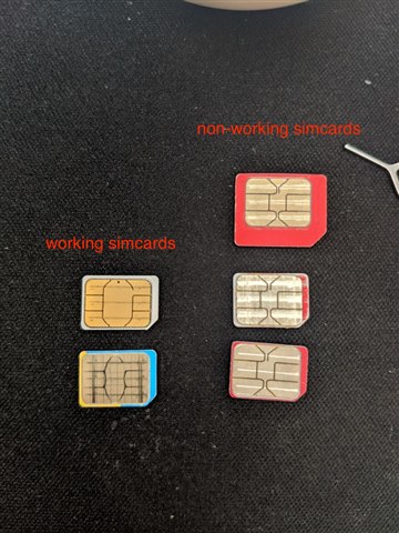

we are facing sim card detection issue with nrf9160 dev-kit. This is the same issue as described here: nrf9160 - SIM communication problem - Ooredoo SIM . Multiple sim cards we have from one operator are working, and multiple sim cards from different operator are not working at all returning %XSIM: 0,9 error.
Based on suggestions we found on this forum we decided to check if the non-working sim cards are supporting 1.8V. So we took simcom7080g modem, which also supports only 1.8V sim-cards and checked with it - everything is working properly and the sim-card is detected and capable to successfully register to the network.
We have also contacted operator to confirm - they cannot say precisely whether the sim cards have 1.8V support, but they should have support and suggested us to send a new batch of sim cards, which we have ordered and checked with same negative result. But since simcom7080g is capable to work with them, we assume they have 1.8v support. So even sim cards from 2 different batches from the same operator are not working.
Additionally we have checked voltage supply to sim cards. For working sim-cards nrf9160 provides and holds voltage. For non-working nrf9160 provides voltage for short period of time and then disables it. So we assume this is related to initialisation procedure of the sim card. So we decided to install nrf9160dk_serial_lte_modem_debug_2023-06-01_0677b099.hex firmware and check logs from RTT, unfortunately there are no useful logs (errors):

We have also noticed that working and non-working sim-cards are different in terms of pins area. Not sure it impacts somehow, but please see the picture:
To sum it up, we assume this is not related to 1.8V, but to sim card initialisation procedure. Please help to overcome this issue because this is the only operator in the country, which is supporting NB-IoT and we can't launch the solution.
