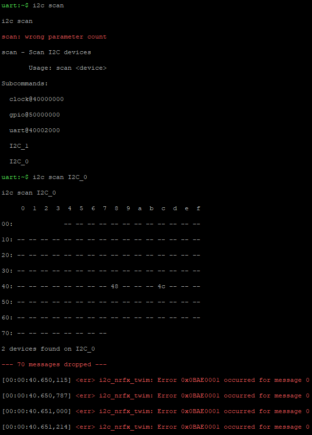

Custom 52832 board, NRF Connect 2.4.0 - TWIM doesn't work (TWI - does)
I am trying to access I2C device - onboard Holyiot 21061 board. When setting in DT the compatibility to "nordic,nrf-twim" - I2C isn't able to communicate with a device. I do not have an analyser, but all APIs return -EIO.
In the output of I2C shell "i2c scan" command - no devices are found. But when I change the compatibility to "nordic, nr-twi" (w/o trailing "m") - everything works OK.

i2c0: &i2c0 {
	status = "okay";
	compatible = "nordic,nrf-twi";
	pinctrl-0 = <&i2c0_default>;
	pinctrl-1 = <&i2c0_sleep>;
	label = "I2C_0";
i2c1: &i2c1 {
	status = "okay";
	pinctrl-0 = <&i2c1_default>;
	pinctrl-1 = <&i2c1_sleep>;
	label = "I2C_1";

Please advise (main() function is just an endless loop of k_msleep(1000))
