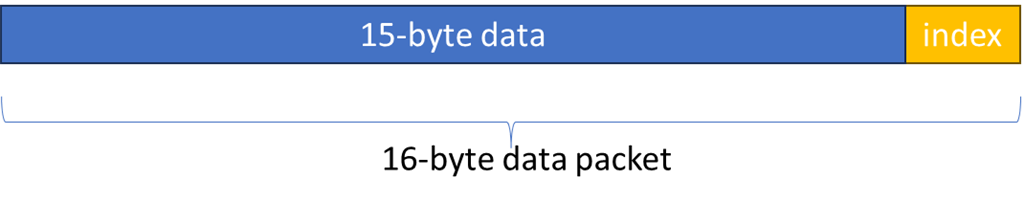

I'm setting up 02 peripheral devices (nRF53832 Dev KIT) that connect to a central device (nRF52840 Dev KIT). In the past few days, I've tested its throughput using only 1 peripheral device to send data to the central one at 250 samples/sec with 16 bytes data packet (15-byte data packet + 1 byte index to check if any data packet loss) as shown in the following figure. I'm using SDK17.02 and NUS service for both peripheral device and central device. I'm using 2M PHY, DLE enabled and ATT MTU 247 bytes.

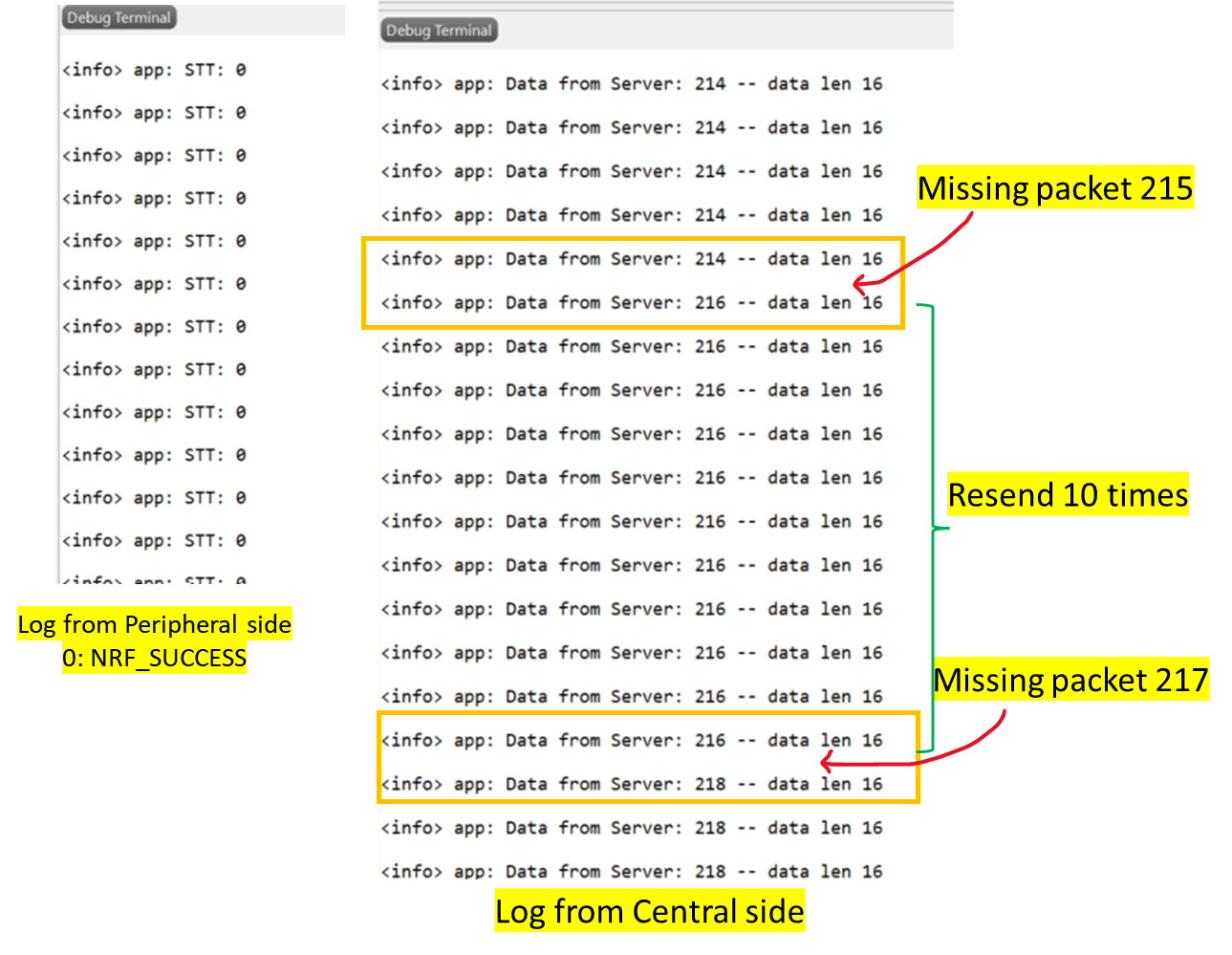

I put this function in while (1) loop along with my sensor data saved in array as one of parameters (uint8_t* p_data) in the main.c to keep sending data. The error I got from this function: sd_ble_gatts_hvx() is NRF_ERROR_RESOURCES. Following some suggestions on other posts like this [1, 2], there are two approaches I used:
Approach #1: Once I receive NRF_ERROR_RESOURCES, I resend the data packet till the error goes away. I keep printing the err_code and it showed NRF_SUCCESS; however, I checked on the terminal debug of the central device, I'm still seeing some data packet loss. I noticed some data packets were resent several times. The following illustrates what I'm saying. P/s: I checked on the index number (16th byte) of each data packet and printed out on the central side.

Please advise on if I need to update/modify the above approaches to solve data loss problem. Thanks!
  • I forgot to mention that if I use an Android phone as a central. Data packet loss never happens.

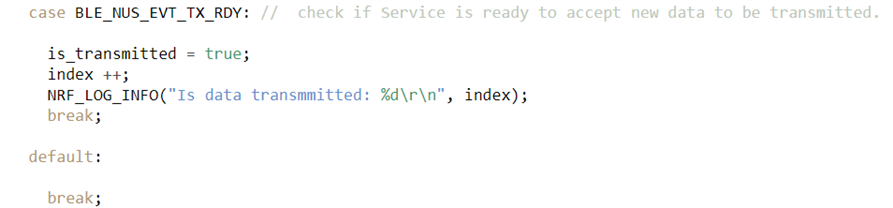

    Regarding the event BLE_NUS_EVT_TX_RDY, I put a counter in the following code to see if it is triggered linearly or not and I was able to receive a counter with increment by 1. It means, whenever 16-byte data packet was successfully transmitted, the counter in that event increased by 1. I'm wondering if any setup I need to to notice from the central side?
     * @param[in] p_evt       Nordic UART Service event.
        uint32_t err_code;
        switch(p_evt->type)
    	case BLE_NUS_EVT_RX_DATA:
                  do
                      if ((err_code != NRF_SUCCESS) && (err_code != NRF_ERROR_BUSY))
                          NRF_LOG_ERROR("Failed receiving NUS message. Error 0x%x. ", err_code);
              if (p_evt->params.rx_data.p_data[p_evt->params.rx_data.length - 1] == '\r')
    	case BLE_NUS_EVT_TX_RDY: //  check if Service is ready to accept new data to be transmitted.
    	  is_transmitted = true;
    	  index ++;
    	  NRF_LOG_INFO("Is data transmmitted: %d\r\n", index);
    	default:
    /**@snippet [Handling the data receive
  • It is likely there is a disconnect-connect event using the nRF52840 (which has a poor antenna compared to the Android phone) which will cause loss of a packet unless you add a handler to work around the issues caused by such an event. To prove this add a counter which increments on each BLE disconnect and compare with the packet loss counter; force a few disconnects on the Android by walking away. For a more in-depth discussion see dropped-packets-with-bt_nus_send
            case BLE_GAP_EVT_CONNECTED:
                // Indicate number of connections for checking against missing packets
                mBleConnectionCounter++;
