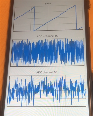

    Just wanna make sure you got my point, here is a brief diagram of my system: Data from peripheral devices are sent to nRF52840 with central role. The nRF52840 with peripheral role then sent data to a phone app.
    Peripheral devices (nRF52832) ----(send data)----> nRF52840 (Central role) ----(Peripheral role) -----(send data)---> a phone app.
    Here is a short video showing how data are collected from a phone app. As you can see, the first graph (index) is showing number of packets being sent from nRF52840 with peripheral role. It wasn't smooth, meaning data loss is happening.
    My question is that did data loss happen from the peripheral devices (nRF52832) sending data to nRF52840) or from nRF52840 sending data to the phone app? Thanks!
  • Hi
    Thank you for the update. What application exactly is your nRF peripheral and central projects based on? Could you try with the throughput sample and see if you have the same issue there? https://developer.nordicsemi.com/nRF_Connect_SDK/doc/latest/nrf/samples/bluetooth/throughput/README.html
    If you're just using a modified version of the Peripheral and Central UART applications it could be that a buffer is filling up either on the transmitting or receiving side if you're transmitting over BLE faster than the UART buffer can handle the messages for example.
