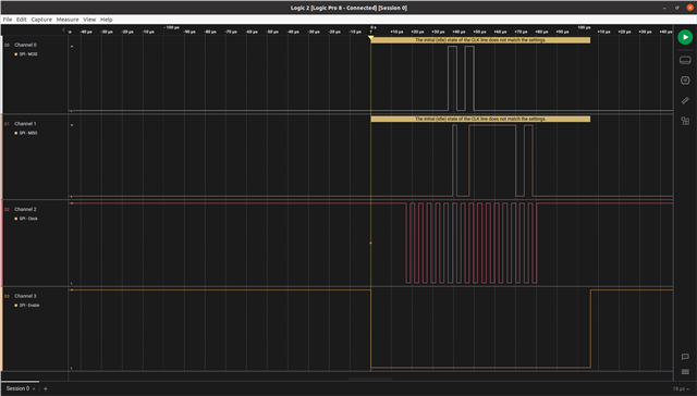

 This is a screen shot of the adxl372_id function in action (
How do I configure the GPIO pins I'm using for SCLK and MOSI to be NRF_GPIO_PIN_H0H1 ? Should I do that GPIO configuration in my Overlay file and how would I do that?

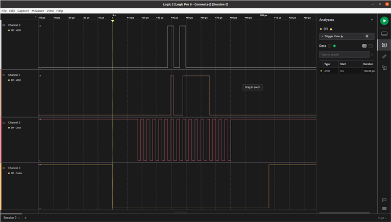

    But as you can see in the following screen shot of my logic analyzer's output
    The clock line is normally high. Shouldn't the clock be normally low, (like MOSI and MISO)? Doesn't the SPI peripheral automatically configure it that way or is that something I have to do? You can see the analyzer doesn't like it.

  • Got hung-up on something else for a bit.
    I misconfigured the spi_config structure in my code. I had SPI_MODE_CPOL defined as part of the .operation member. This changes CPOL to 1 from the default value of zero so naturally the clock line was set high since I was telling the SPI device to set the clock polarity to 1.
    Also, in addition to keeping the bread board wiring as short as possible, Wes Cherry, (a  Nordic Field Application Engineer), tipped me off to adding the following to my overlay file:
    /* Enable high drive mode for the SPI3 pins to get a square signal at 8 MHz */
    &spi3_default {
        group1 {
            nordic,drive-mode = <NRF_DRIVE_H0H1>;
    Everything works as expected. Thank you.
