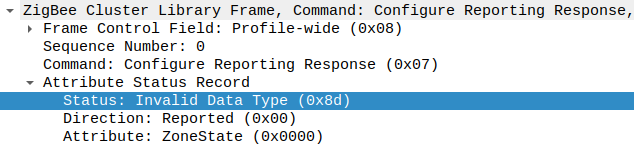

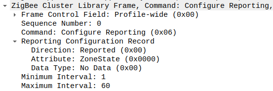

So commisionning works fine. However when i try to close, open door sensor, nothing happen. I try to use sniffer, but the result is the same. I tried using zdo match_desc as suggested here but there only the following logs:
uart:~$ zdo match_desc 0xffff 0xffff 0x0104 2 0x0402 0x0403 0
Sending broadcast request.
 I: Unimplemented signal (signal: 50, status: 0)
Done
How should i modify my code in order to have open/close door event ? Is there any tutorial up to date to implement ias zone sensor ?
