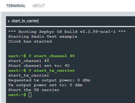

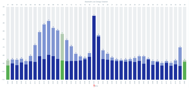

    You should make sure the Radio test sample runs on your test target BC840E board and get the boot-up log as my figure. Then, type the commands and get the corresponding return.
    Amanda Hsieh said:
    Then, use a nRF52840DK to connect the nRF RSSI viewer app.
    -Amanda H.

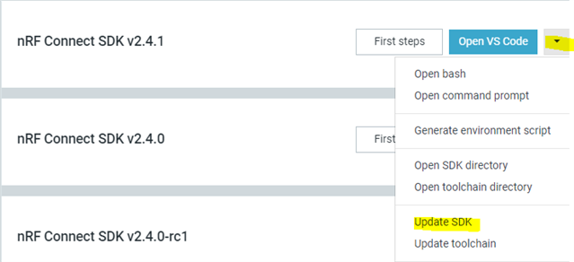

    Which NCS version are you using?
    The radio_test sample can be found under samples/peripheral/radio_test in the nRF Connect SDK folder structure.
    I would suggest you update the SDK via the Toolchain Manager and then load the radio_test sample from the NCS instead of downloading it from the web.
    -Amanda H.

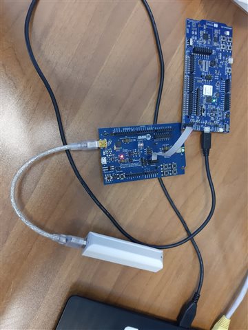

  • OK, I solved the update issue, now the building of the "radio_test" application seems to work.
    I remind you that I have 2 boards, the nRF52840 board and the BC840E evaluation board.

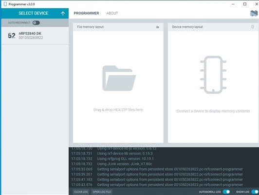

    I loaded the radio test programme into the nRF52840 board connected via USB to the PC, and using the "flash" in VS Code.
    To this first board the BC840E board is connected via a 10-wire connection (for the power supply the BC840E is not connected via USB to the pc, but to an external battery), and according to what you told me above, by flashing the programme to the nRF52840 connected via 10 wires to the BC840E, the same programme should also be loaded inside this second board.
    Then through the serial terminal I give the commands you wrote me above ("start_channel" 40 and "start_tx_modulated_carrier"), always with both boards connected as I described, but opening the serial terminal I see these writings printed:
    "bfdegeffcgfedd e!e "f#d$f%f&e'e(f)f*f+c,e-f.g/f0d1g2g3f4f5c6f7g8f9g:c;d<e=g>g?c@eAfBfCgDdEfFeGfHfIdJeKfLeMgNdOfPddffeedee d
    f
    f
    ceffgadfgfddedbgfe e!b "e#f$f%f&e'f(f)e*g+d,g-e.f/g0c1f2f3g4f5e6g7g8e9e:a;g<d=e>f?b@eAfBgCgDdEgFeGfHfIcJfKfLeMhNdOfPfehfeedcd e
    f"......
    The boud rate is correct and I have also tried flashing the board via the NRF Programmer, loading the file 'zephyr.hex' (always keeping the same configuration), instead by VS Code, but it produces the same result.
    That seems to be the correct way you described to me to programme the second BC840E board.

  • The baud rate is 115200 on the serial settings.
    When I connect only the nRF52840 board to the PC and load the zephyr.hex programme (i.e. without the 10 connection wires to the BC840E) the serial terminal seems to work.
    Instead it prints in the serial terminal continuously the same values I showed you above if I program the nRF52840 with the 10 connection wires attached and then the BC840E as well.
    I tried changing USBs and Putty and the same thing happens.
    Are we sure that's the right way to programme the BC840E? I'm pretty sure the problem lies in flashing the programme on nRF52840 when the other board (BC840 E) is also attached via 10 wires, because only in this case does the programme give problems.

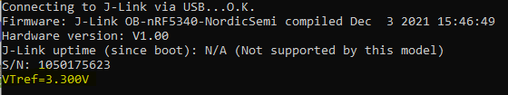

    From the doc, it seems like that. You also could use the J-Link debug probe to replace nRF52840DK for programming. Do you also try other BC840 E boards? If you also have programming issues with the J-Link debug probe, you should contact the provider since BC840 E is not produced by Nordic.

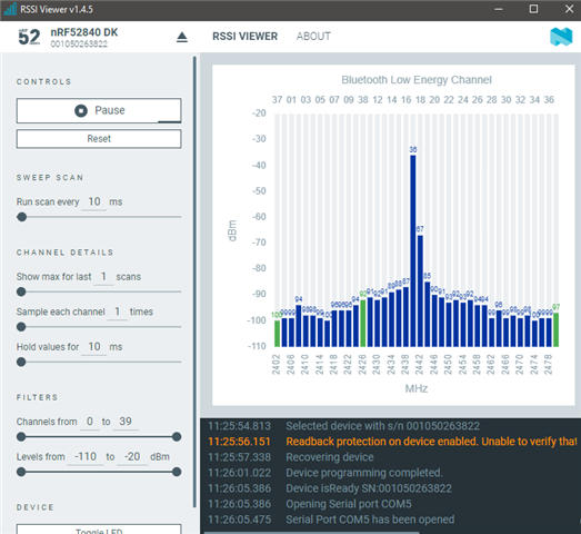

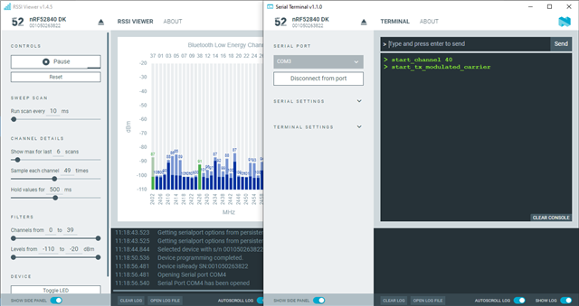

  • Hi Amanda,
    I was able to solve the problem and now I can send the carrier from one board and view it via RSSI viewer on the other (with the "radio_test" application).

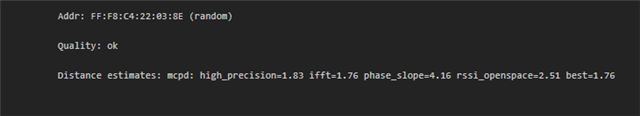

    To go back to the previous problem, that is, the RSSI value measurement with the "nrf_dm" application, where I was seeing inconsistent RSSI values.

  • Hi Amanda, unfortunately the examples you gave me were not very helpful, they don't explain how to extract RSSI values over time.
    Concerning the second request, the problem is this, when I use the RSSI viewer on the nRF52840 DK, and the radio_test loaded on the BC840 then I read correctly the RSSI value from the RSSI viewer (the two boards are at a distance of 60 cm, so the path loss at 2.4 GHz is about 36 dB, then on the BC I mounted an antenna that has gain 5 dBi, and transmitting 0 dBm with the BC I see that the RSSI is about -34 dBm, as I expect).
    Leaving the same setup, with the nrf_dm example, it prints me an absolutely incorrect RSSI value, we are around -2 dBm (perhaps because in the latter case I see the sum of several channels?).
    So I cannot use the nrf_dm example to extract the RSSi values I need, but I should do it from the RSSI viewer, because from there I read the value I expect according to RSSI theory.
