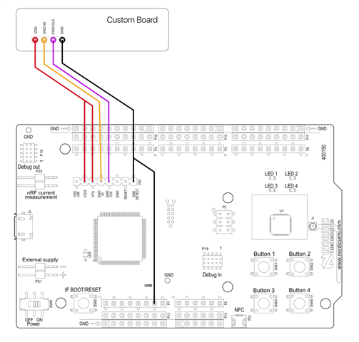

nRF51822 chip nRF5 DK chip programing error "Error when running operation: protection.get"
Hello Nordic Representative,
I am currently trying to program/upload a hex file into a new Bluetooth chip (nRF51822) using the nRF5 DK. ID PCA10028. I had previously been able to load files as need with the nRF connect, but I am now suddenly having an error that relates to the error of protection.get. I have tried to resolve this, such as using the nrfjprog --recover command, however this does not seem to work.  nRF Connect for desktop gives Device Protected
The connection to the chip appears to be correct and everything else seems to operate the same as when I had previously worked on the chips. Attached is a pdf with the related images, both with the error of the connected chip to DK, the connection showing no issues with just the DK using nRF connect, nrfjprog results and a layout of the circuit setup as suggested by the following ticket.  Programming external board from nRF51-DK / nRF52-DK stopped working
Photos.pptx
    Have you tried recovering the device using the 'erase all' button in the Programmer app?
    Can you upload the complete log from the Programmer app? Click on 'open log file', copy the contents of the file and upload it here by going to Insert > Code and pasting the log there.
    Marte
  • Hello Marte,
    I have tried running the erase all button as well. However it reads the following line. "Skipped reading, since at least one core has app readback protection"
    LOG FILE:
    2023-08-03T20:22:09.075Z DEBUG Application data folder: C:\Users\19apt1\AppData\Roaming\nrfconnect\pc-nrfconnect-programmer
    2023-08-03T20:22:09.130Z DEBUG App pc-nrfconnect-programmer v3.0.9 local
    2023-08-03T20:22:09.130Z DEBUG App path: C:\Users\19apt1\.nrfconnect-apps\node_modules\pc-nrfconnect-programmer

    2023-08-03T20:22:19.770Z INFO Loading readback protection status for Application core
    2023-08-03T20:22:19.770Z DEBUG Sending usage data {"category":"pc-nrfconnect-programmer","action":"Open device","label":"jlink"}
    2023-08-03T20:22:20.030Z INFO Readback protection status: NRFDL_PROTECTION_STATUS_NONE
    2023-08-03T20:22:20.273Z INFO Parse memory regions for Application core
    2023-08-03T20:22:20.274Z INFO Update files regions according to Application core
    2023-08-03T20:22:20.275Z INFO Parse memory regions for file
    2023-08-03T20:22:20.279Z INFO Device is loaded and ready for further operation
    2023-08-03T20:22:20.280Z INFO Reading memory for NRFDL_DEVICE_CORE_APPLICATION core
    2023-08-03T20:22:20.572Z ERROR Failed to get device memory map: async task failure for id: 93033750 msg: [jlink] JLINKARM_DLL_READ_ERROR (Origin: "Error when running device operation fw-read")

    2023-08-03T20:22:29.041Z INFO Loading readback protection status for Application core
    2023-08-03T20:22:29.041Z DEBUG Sending usage data {"category":"pc-nrfconnect-programmer","action":"Open device","label":"jlink"}
    2023-08-03T20:22:29.429Z ERROR Failed to load readback protection status: async task failure for id: 101794426 msg: [jlink] JLINKARM_DLL_ERROR (Origin: "Error when running operation: protection-get")
    2023-08-03T20:22:29.430Z DEBUG Sending usage data {"category":"pc-nrfconnect-programmer","action":"Report error","label":"win32; x64; v3.0.9; Failed to load readback protection status: async task failure for id: 101794426 msg: [jlink] JLINKARM_DLL_ERROR (Origin: \"Error when running operation: protection-get\")"}
    2023-08-03T20:22:29.432Z INFO Parse memory regions for Application core
    2023-08-03T20:22:29.433Z INFO Update files regions according to Application core
    2023-08-03T20:22:29.433Z INFO Parse memory regions for file
    2023-08-03T20:22:29.435Z INFO Device is loaded and ready for further operation
    2023-08-03T20:22:29.435Z INFO Skipped reading, since at least one core has app readback protection
    2023-08-03T20:22:34.311Z INFO Recovering NRFDL_DEVICE_CORE_APPLICATION core
    2023-08-03T20:22:34.694Z ERROR Failed to recover NRFDL_DEVICE_CORE_APPLICATION core: async task failure for id: 107064957 msg: [jlink] JLINKARM_DLL_ERROR (Origin: "Error when running operation: recover")

    2023-08-03T20:28:49.845Z INFO JLink OB firmware version J-Link OB-SAM3U128-V2-NordicSemi compiled Nov 7 2022 16:21:57
    2023-08-03T20:28:49.846Z DEBUG Sending usage data {"category":"pc-nrfconnect-programmer","action":"Open jlink OB version","label":"J-Link OB-SAM3U128-V2-NordicSemi compiled Nov 7 2022 16:21:57"}
    2023-08-03T20:28:49.846Z INFO Device family NRF51_FAMILY
    2023-08-03T20:28:49.847Z DEBUG Sending usage data {"category":"pc-nrfconnect-programmer","action":"Open jlink device family","label":"NRF51_FAMILY"}
    2023-08-03T20:28:49.847Z INFO Device version NRF51xxx_xxAC_REV3
    2023-08-03T20:28:49.847Z DEBUG Sending usage data {"category":"pc-nrfconnect-programmer","action":"Open jlink device version","label":"NRF51xxx_xxAC_REV3"}
    2023-08-03T20:28:49.848Z INFO Board version PCA10028
    2023-08-03T20:28:49.848Z DEBUG Sending usage data {"category":"pc-nrfconnect-programmer","action":"Open jlink device board version","label":"PCA10028"}
    2023-08-03T20:28:49.848Z INFO Loading readback protection status for Application core
    2023-08-03T20:28:50.237Z ERROR Failed to load readback protection status: async task failure for id: 482430295 msg: [jlink] JLINKARM_DLL_ERROR (Origin: "Error when running operation: protection-get")
    2023-08-03T20:28:50.237Z DEBUG Sending usage data {"category":"pc-nrfconnect-programmer","action":"Report error","label":"win32; x64; v3.0.9; Failed to load readback protection status: async task failure for id: 482430295 msg: [jlink] JLINKARM_DLL_ERROR (Origin: \"Error when running operation: protection-get\")"}
    2023-08-03T20:28:50.240Z INFO Parse memory regions for Application core
    2023-08-03T20:28:50.241Z INFO Update files regions according to Application core
    2023-08-03T20:28:50.241Z INFO Parse memory regions for file
    2023-08-03T20:28:50.242Z INFO Device is loaded and ready for further operation
    2023-08-03T20:28:50.242Z INFO Skipped reading, since at least one core has app readback protection

  • Understood, full circuit can run under 3.6 so that should not be a problem. Still not sure why the chips won't operate.
  • Have anyone checked the schematic to ensure you have followed the reference schematic in terms of component placement and values?
    Kenneth
  • Yes, and I had tried a circuit that had worked previously but no longer is compatible it seems. I either get this protection error or it remains as a JLINK notification indicating bad connections. However, whenever I or a colleague checks the resistances everything seems in order. We will try with a different computer to see if it ends up being the issue.
  • Hello Kenneth, sorry got side tracked with other projects. The error still arises from the newer chips we had received so had to start using older chips which seem to avoid the issue. As an aside, if I am trying to send EMG analog signals through the low power bluetooth chip configuration, am I able to send it via a sampling rate of at least 1k? Is there a particular example code you would suggest I look to for reference regarding making changes to the advertisment rate? A colleague is having issues with being unable to reach that sort of sampling rate.
