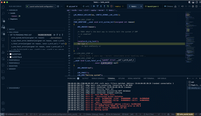

MPU FAULT during gatt service discovery
I'm trying to connect to 15 BLE devices. I've followed the code at: https://github.com/NordicMatt/multi-NUS/ but have modified it to filter by the device name and then write to a specific characteristic once it has discovered the services. I'm using a nRF528040-DK and the nRF Connect SDK v2.4.1
This works great up to about 12 devices. However when I try to connect to more than 12 devices I will intermittently get this error
[00:00:13.189,636] <err> os: ***** MPU FAULT *****
[00:00:13.189,636] <err> os:   Instruction Access Violation
[00:00:13.189,666] <err> os: r0/a1:  0x200027e8  r1/a2:  0x00000000  r2/a3:  0x2000d918
[00:00:13.189,697] <err> os: r3/a4:  0x20011efc r12/ip:  0x00000013 r14/lr:  0x0003043f
[00:00:13.189,697] <err> os:  xpsr:  0x60000000
[00:00:13.189,727] <err> os: Faulting instruction address (r15/pc): 0x20011efc
[00:00:13.189,758] <err> os: >>> ZEPHYR FATAL ERROR 20: Unknown error on CPU 0
[00:00:13.189,788] <err> os: Current thread: 0x200021c0 (BT RX)
[00:00:13.320,098] <err> os: Halting system
The error however doesn't occur after the 12th connection but right after I run this code:
bt_gatt_dm_start
at a random connection (i.e. one time it occurs after the 15th connection, another time after the 3rd connection). However the error only occurs when I'm trying to connect to more than 12 devices (i.e. when I run bt_scan_filter_add 12 or more times)
but before my discovery_complete callback is called from logging at different points in my application.

I'm new to the nRF5280 so any help with ways I can further debug this would be appreciated.

Update 03/08/23
Following  Understanding a FATAL ERROR in my application  tried running the code with the debugger. However it didn't break when the fault occurred, instead I had to manually pause it after seeing the fault be logged.
The call stack is interesting. While the log says the fault occurred in the BT RX thread the call stack says it occured in the BT TX Thread (see image above). When I commend out my bt_gatt_write the error does stop. However I don't know how to fix the error while still being able to write to the characteristics
