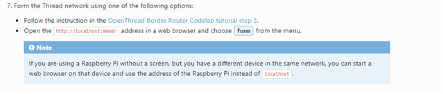

  4. After implementing step 6 in the command line, it seems necessary to open the IP address corresponding to the Raspberry PI in the local browser and add the suffix ":8080", click in the "FORM" to generate the Thread network. Can this step be implemented through the command line? And I wonder if the point of this step is just to generate the Thread network that I built? Do you need to connect to the public network to authenticate anything through the server?
    I will have to check up on the last one. I will get back to you with something constructive once I know more.
