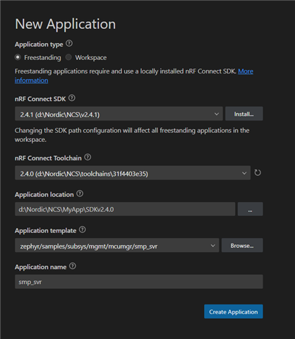

  • Hi Jerry,
    I attached here how i built the project with VS Code:
    First you create new application based on smp_svr:

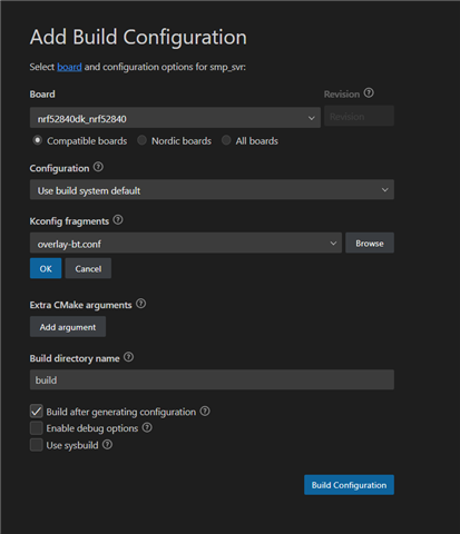

    After that you create the configuration, and select the overlay_bt.conf as the Kconfig fragments, make sure you click OK after you select the file:
    After the build, you should be able to find overlay_bt.conf in the project configuration:
    I attached here the hex file that worked for me:
    4544.merged.hex
  • Hi Hung,
    I followed your excellent instructions and voila, I can see the advertisement on iPad!
    Thank you so much!
