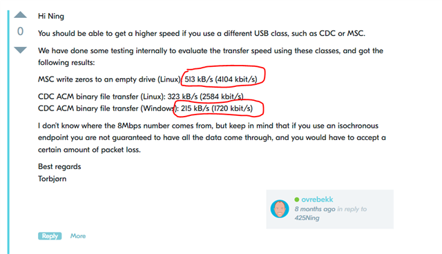

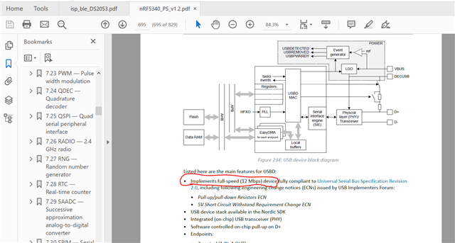

How to make the speed of USBD on nRF5340 reach to 12Mbps
Dear Support Team
As said in the nRF5340 product specification file, the nRF5340's USBD support full-speed 12Mbps.
I would like to use the USBD on nRF5340 to store data to the NAND Flash, which example is recommended and how to make the USBD speed reach to the 12Mbps in this case?
