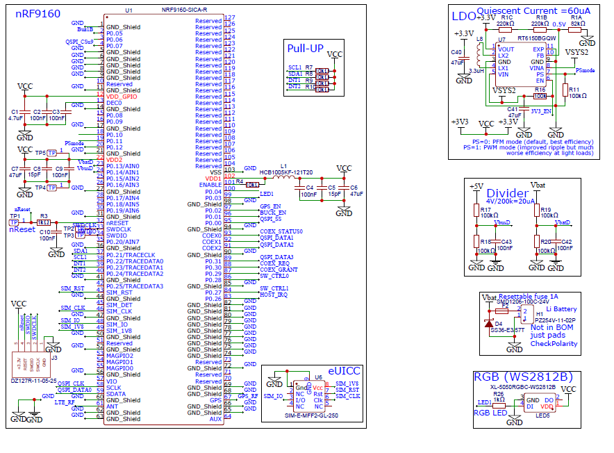

Hi All,
I am trying to test a single WS2812B led wired to the GPIO 3 of my nrf9160 custom board (designed by someone else), I would like to use the PWM driver as I am unable to build the led_ws2812 sample since the nrf9160 is not supported.
Here it seems that this LED can be controlled with nrf9160 and PWM via GPIO. I am able to build and flash my board with the rgb_led basic sample however the led on my board do not turn on. I am not sure if this is a hardware or software error. I program my board with a J-Link EDU Mini via SWD pins and the board is connected to a 3.7v power supply, the LED does turn on if I directly connect it to the power supply.
I also use the NRF connect SDK 2.4.1 with VS code.
I am very new to nrf connect and followed the instructions I could find in the documentation here. Any help would be greatly appreciated.
Best wishes
My custom pcb schematic

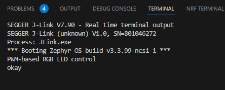

RTT output
build log trace
logtrace.zip
  • Hi ax_shepherd,
    Thank you for the detailed information.
    I think you might have misunderstood how the WS2812 LED works. It is a chainable/scalable LED that is controlled using a 1-wire interface, not via regular PWM.
    I think you can still use the led_ws2812 as a base. It demonstrates the WS2812 Driver usage on two nRF52832 boards, thingy52_nrf52832, and nrf52832dk_nrf52832. The WS2812 Driver implements the 1-wire interface of the LED using the I2S or SPI peripherals of the nRF52832.
    The sample shows how to setup the I2S version of the driver with the thingy52 board, and the SPI version with the nrf52dk board. You will need to choose one of the two approaches, and replicate it for the nRF9160.
    Secondly, in your design, the nRF9160 logic level is 3.3V, while the WS2812 input is specified at 5V. Some online discussions I found suggests that it might still work, but please pay attention to this.
    Thirdly, also in your design, the WS2812 is powered by VCC 3.3V. Just like above, some online discussions suggest that it would still work, but with bad color correctness.
    Hieu
  • Hi Hieu,
    I manage to make it work by following the tutorial here to create a working template for my nrf9160 based custom board. And I used the MOSI pin of the arduino_spi to drive the WS2812 based on this sample.
    nrf9160vs_nrf9160.overlay
