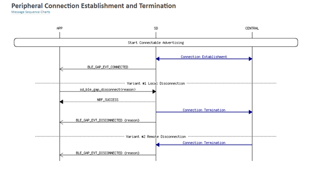

    First, I would like to point out, that if you put the nRF52811 into system off sleep while it's in a connection, then it's natural to expect the other side of the connection to result in a GATT_CONN_ERROR as the connection will be disrupted. Before you go to sleep, you should send a disconnect event, by disconnecting from the peer.

    I have another question or favor to ask. Can you please explain how can I send a disconnect event by disconnecting from peer.

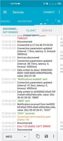

    So I tried reproducing this by using a devkit and the ble_app_hrs example from the nRF5SDK.
    I tried:
    1. Disconnecting gracefully by sending a disconnection event to the mobile phone. This is done by pressing button 1, which will disconnect by calling sd_ble_gap_disconnect(). See the BSP_EVENT_DISCONNECT case in the ble_app_hrs example to see how it's implemented.

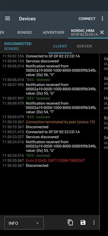

    2. Disconnecting by turning off the device, this will simulate a device crashing. No disconnecting event is then sent to the peer.
    In the first case the DK sent a disconnect event to the peer and the connection was disconnected gracefully, no error reported.
    In the second case, the DK never sends a disconnection event and the log is terminated after a connection TIMEOUT which will result in an error,.
    The picture below shows first a connection then case 1 where I disconnect gracefully, no error reported. Next, it shows another connection event and the device "crashing" resulting in an timeout error.
    What kind of phone are you using? How a disconnection event is handled can be dependent on the specific phone used.

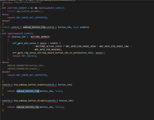

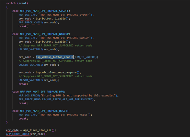

    The error is gone now but i can't wake up the device with a GPIO(pin 18) now , Please see if you can let me know where I am wrong .
    Here is my code for sleep mode
     nrf_gpio_cfg_input(18, NRF_GPIO_PIN_PULLUP);
    nrf_gpio_cfg_sense_input(18, NRF_GPIO_PIN_PULLUP, NRF_GPIO_PIN_SENSE_LOW);

    You should also add nrf_gpio_cfg_sense_set(),
