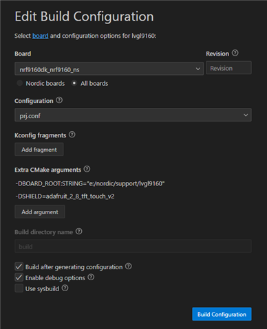

  • If you don't have an overlay. Where did you then set up the device tree for display?
    If you are using a nRF9160dk then you have an debugger on the DK
    Modify your build configuration like this:
    Then starta  debug session
    And
    Regards
    Runar

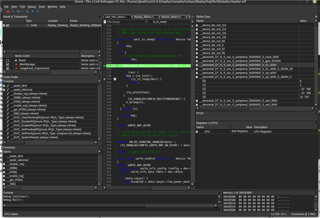

  • Hi Runar,
    I do not have VS code installed with all the required things for dubugging. It works but it breaks in the meantime. Also, regarding the overlay file, I have updated the corresponding .dts files in /arm/boards directory of my Zephyr installation.
    I normally use command line to flash to the board, with -- -DSHILD option selected while building.
    So for debugging I recently download the Ozone for that, and could set breakpoints and see all other debug functionalities. The Code works normally with "CPU running" status and do not show any error.
    I do not know yet...I am relatively new to debugging with software.

    I'm a bit confused her, so just need to be sure that we are on the same page. You should not need anything special installed to debug with VSCode. Could you describe your setup?
    You are not suppost to edit the .DTS directly since this then will affect all other projects you create with the same board.  So I would highly suggest that you revert the changes to your devicetree and instead use an overlay.
    It is not recommended to modify the devicetree directly, so instead we use devicetree overlays to do this. The overlay only needs to include the node and property it wants to modify."
    https://academy.nordicsemi.com/courses/nrf-connect-sdk-fundamentals/lessons/lesson-3-elements-of-an-nrf-connect-sdk-application/topic/configuration-files/
    Regards
    Runar
