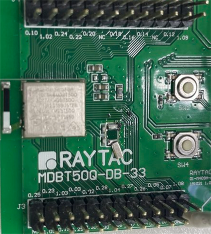

Hello I'm in trouble with nRF52833 module MDBT50Q-DB-33(with no 32kXtal)
in nrf connect sdk v2.3.0
I remove the 32k clock for new designed board and test with MDBT50Q-DB-33.

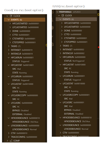

I trace with debugger and can not detect difference(means looks same code).
and now I noticed in "lfclk_spinwait", debugger said...
HFCLKSTARTED not 1(= not started) and LFCLKSRC =Xtal
when set CONFIG_BOOTLOADER_MCUBOOT
