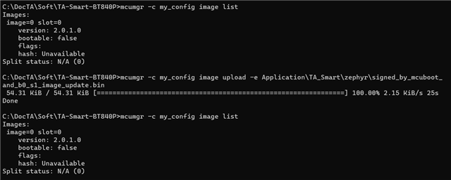

    Thank you very much for your answer.
    I've been working on this for 2 weeks but unfortunately I still have problems...
    Here at the moment, I'm trying to find a way to update the devices that are with my customers (with the nRF5 SDK) so that it's not too complicated for us and for them to manage the updates of old devices and new ones (with NCS SDK). I think the simplest solution would be to manage to only update the app of the devices that are with my customers (therefore keeping the old bootloader and the softdevice present in the devices).
    To do this, I tried to do like Vidar Berg with his project 2273.peripheral_lbs.zip (devzone.nordicsemi.com/.../hang-with-nrf5-sdk-17- 1-0-bootloader-and-nrf-connect-sdk-2-1-0-application) but unfortunately there must be things I forgot because it doesn't work.
    When I compile my project and flash it, it works on my device. On the other hand, if I send the update to a device working with the nRF5 SDK, it accepts the update but afterwards it is blocked.
    Here are the problems I'm seeing that I don't know how to fix:
    - In the prj.conf file of my project, I put "CONFIG_FLASH_LOAD_OFFSET=0x27000" but it is the value 0xC000 which is put (I have a warning for that in the logs).
    - In my mcuboot.cong file in the child_image folder, I added "CONFIG_SINGLE_APPLICATION_SLOT=y". Despite this, I have to provide memory in my pm_static.yml file for mcuboot_secondary otherwise I get a compilation error: do you know why?
    Here are my DFU logs:
    3312.test.log

    Here I only put the MCUboot to simplify but then I would like to add the CONFIG_SECURE_BOOT.
    Thanks for your help !
    QuentinD said:
    -- Application: C:/DocTA/Soft/TA-Smart-BT840P/SDK/nRF_Connect/v2.3.0/bootloader/mcuboot/boot/zephyr
    I see you're using NCS v2.3.0 from your logs. This sample is only working with NCS v2.1.0 out of the box and it will not be updated as it is not an official sample. I recommend you to make it work with NCS v2.1.0 before attempting to port it to v2.3.0.
    After you've made it work for v2.1.0 you can have a look at the changelogs in the SDK versions to see what changes has been made w.r.t DFU and the bootloaders. There are certain changes in Zephyr in between v2.1.0 and v2.2.0 that will have to be implemented.
    Andreas

    Here it's what I did to update the bootloader:
    1. Reboot device (button on the PCA10056)
    2. Send the cmd: mcumgr -c my_config image upload Application\TA_Smart\zephyr\signed_by_mcuboot_and_b0_s1_image_update.bin
    -> file of  54.27 KB

  • Thank you for your response but I'm sorry I still can't update the bootlaoder.
    I configured MCUBOOT_SERIAL_DIRECT_IMAGE_UPLOAD=y.
    I tried these commands:
    mcumgr -c my_config image upload Application\TA_Smart\zephyr\signed_by_mcuboot_and_b0_s1_image_update.bin -n 1 --> this writes the file to my application partition (mcuboot_primary)
    mcumgr -c my_config image upload Application\TA_Smart\zephyr\signed_by_mcuboot_and_b0_s1_image_update.bin -n 2 --> this writes the file to mcuboot_secondary (after reboot, nothing is copied to the s1 partition)
    mcumgr -c my_config image upload Application\TA_Smart\zephyr\signed_by_mcuboot_and_b0_s1_image_update.bin -n 3
    mcumgr -c my_config image upload Application\TA_Smart\zephyr\signed_by_mcuboot_and_b0_s1_image_update.bin -n 4
    --> I can't load the file because the bootloader returns <inf> mcuboot: RX: 0x3
    So how can I write to the s1 partition? Which partition do "-n 3" and "-n 4" correspond to?

  • Thank you for these explanations.
    The problem I have here is that I cannot execute the commands that you told me (test, confirm, ...) because I do not see the hash and even less the image that I have uploded.
    Here is my upload with the result:
    If I do the upload command without the "-n 2", it overwrites my application (mcuboot_primary). So that's why I put "-n 2" so that the application is not deleted and that it puts the bootloader file in the only partition that I have access to (mcuboot_secondary).
