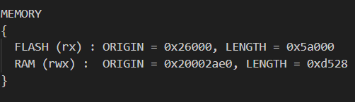

However, weird things started when I uploaded the same firmware on the custom board. The original RAM configurations of custom board are
I know the original RAM configuration between DK and custom board are not the same but since they worked fine in the past, I didn't bother to match them together. But today, after I changed the RAM configuration on custom board to be the same as DK's configuration , the board crashes. Below is the custom board RAM configuration after the change
I thought it's probably the RAM change causing the crash. So instead of matching the RAM configuration of 2 boards, I increase the original RAM location up by 8 (0x20002D30 - 0x20002D28), similar to what I did on the DK. However, the board still crashes.

  • Hi Einar,
    Can you please help me confirm I configure both boards to have same RAM settings?
    Here is my RAM setting in Segger Studio for the DK.
    And below is the RAM setting in GCC for the custom board.

    Also, I just redid the change again from the working firmware. I still cannot find the exact reason why my firmware crashes, but I figured out the reason of this peculiar issue. In GCC, if I change RAM configuration in the .ld file (as shown above), it won't update this configuration until I make any change in the firmware code. For example, if I change main.c and do "make", then I change RAM configuration, then do "make" again (this seems to be ignored by the compiler as no change in firmware is found), then upload the code to custom board via openOCD, the new RAM configuration won't be used. However, if I change main.c, then change RAM configuration, then do "make" again, this time the new RAM configuration will be used. This is 1 step toward solving this weird behaviour.

  • Hi Xander,
    The RAM configuration seems equivalent for the SES and GCC project (same starta address and size).

    Sure I will try this on a different board. Just to confirm, there is only 1 RAM and Flash size option for nRF52832 chip, isn't it? I mean there is no way I can get a nRF52832 that has more RAM than another nRF52832 (I'm talking about internal RAM). Here is the info of my custom board from the ST-Link
    Info : nRF52832-CIAA(build code: E0) 512kB Flash, 64kB RAM
    I just also figured out that if I just changed the RAM of custom board to be the same as DK, app will crash on custom board. This makes me suspect 2 boards have different RAM size.
    Update: Solution found. After many trials on custom board, I realize for any RAM settings that has starting address + size > 0x20010000, it will crash. The DK RAM are 0x20002D28 + 0xDDE0 = 0x20010B08 so it will crash the custom board. From using DK, I know starting address of 0x20002b40 will work with the added characteristic. So I calculate RAM size for custom board to be 0x20010000 - 0x20002b40= 0xD4C0 and this RAM setting work on my custom board. Now I can use the newly added characteristic. By the way,  NRF_SDH_BLE_GATTS_ATTR_TAB_SIZE also has to be changed from 1408 to 1508 to fit the new characteristic
