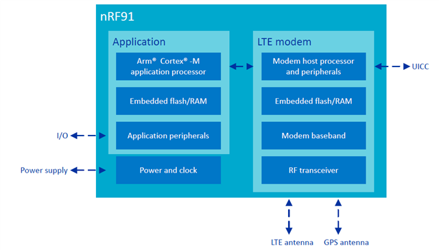

I have a few questions on key/certificate storage on the nRF9160, specifically relating to getting ready to provision them for production
In the image below, its looks like the application core and LTE modem core have separate embedded flash storage.
  1. I am a bit confused by this as the modem firmware, which I assumed is stored on its own embedded flash, can be programmed through nrfjprog / nRF Connect programmer via Jlink.  Are the memories linked?  How is this happening?
  2. The extract from the 9160PS below says that the KMU is stored in the UICR, however ensuring the CPU has no access to stored cryptographic keys. When I erase the UICR on nrfjprog, the keys still remain.  Is this a different memory sector or modem specific memory UICR? I know the keys are meant to be erased via the AT commands on the modem COM, I'm just trying to understand more about the memory layout

  • Hi Chris,
    Thanks for checking us for your questions.
    You can find the explanation about LTE modem from nRF9160 specs. "Application and modem domains interact through the interprocessor communication (IPC) mechanism. The LTE modem is accessible to users through the modem API." The developer should be able to use it with modem library running on the application core.

    I have been updating certificates using both the nRFConnect LTE link monitor, which operates on the modem COM port, and a custom program sending out AT commands on the modem COM port.  Are there any other methods i.e. via Jlink?
    No, AT commands are only supported via the application core uart peripheral.
    JLink programmer/debugger is used for program or debugging fw but not for communication.
