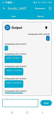

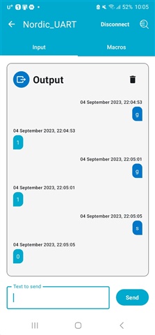

comment or uncomment a code in while loop cause problem?
hi i use pca10056 board with segger embedded studio
i currently facing a bizzarre problem with my project
i use adc function and nus service and low frequency clock
everything went fine with my project until i tried to comment code
       if(bsp_board_button_state_get(BSP_BOARD_BUTTON_2)==1 )
literally this code is the only issue for my project
that code is in main while loop
uncomment that code line has no problem,
comment that code makes my project don't work
which means i have to include that code line in while loop
i could kept developing my code since just uncommnet that code doesn't make any error
but i just wonder what does  commenting that code has to do with error??
i know my question lacks a lot of information but i just wonder if this kind of problem has occcured to someone else.
below is my main code thank you

  • my apologize for not clearing my question.
    i am in learning step with this stuff and  I had never faced this kind of issue
    so i was unable to give enough information
    i used the dk project with nrfToolBox and uart service.
    and i got a screeenshot of them
    i sent g from phone and as shown above,
    i could receive data from board
    this is what i got after i commented that if code in while loop.
    i coded so that it sends adcflag value when g or s is received.
    which is in line 144 uint8_t adcflag
    and as you suggested,
    i initialized adc before while loop.
    and yeah whether that if code is commented or not,
    it worked well. so think putting initial function in while loop
    got messed up in someway.
    thanks for your reply
    best regards
    Lee
