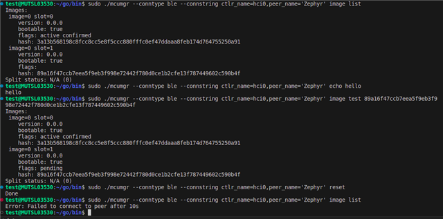

FIrst image is uploaded through smpsvr and second image uploaded is hello_world . In hello_world,prj.conf files has been enabled with mcumgr and smp
See my answer in this post: can you tell the process of device firmware upgrade using BLE through SMP
1. first image uploaded is smp server
2. second image uploaded is added dfu to blinky application
3. still i am receiving the error-failed to connect to peer after 10 sec is coming
Do you have any log output from the nRF53? It might give us some clues about what is happening with device, and why it's not connecting again.
