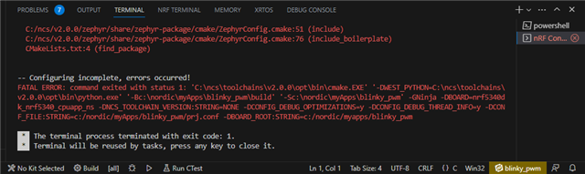

However, when I get to part 3 this throws configuration errors:
Executing task: nRF Connect: Generate config nrf5340_audio_dk_nrf5340_cpuapp for c:\nordic\myApps\blinky_demo
Building blinky_demo
C:\WINDOWS\system32\cmd.exe /d /s /c "west build --build-dir c:/nordic/myApps/blinky_demo/build c:/nordic/myApps/blinky_demo --pristine --board nrf5340_audio_dk_nrf5340_cpuapp --no-sysbuild -- -DNCS_TOOLCHAIN_VERSION:STRING="NONE" -DCONFIG_DEBUG_OPTIMIZATIONS=y -DCONFIG_DEBUG_THREAD_INFO=y -DBOARD_ROOT:STRING="c:/nordic/myapps/blinky_demo""
-- Application: C:/nordic/myApps/blinky_demo
-- CMake version: 3.20.5
-- Found Python3: C:/ncs/toolchains/31f4403e35/opt/bin/python.exe (found suitable exact version "3.8.2") found components: Interpreter
-- Cache files will be written to: C:/ncs/v2.4.1/zephyr/.cache
-- Zephyr version: 3.3.99 (C:/ncs/v2.4.1/zephyr)
-- Found west (found suitable version "1.0.0", minimum required is "0.7.1")
-- Board: nrf5340_audio_dk_nrf5340_cpuapp
-- Found host-tools: zephyr 0.16.0 (C:/ncs/toolchains/31f4403e35/opt/zephyr-sdk)
-- Found toolchain: zephyr 0.16.0 (C:/ncs/toolchains/31f4403e35/opt/zephyr-sdk)
-- Found Dtc: C:/ncs/toolchains/31f4403e35/opt/bin/dtc.exe (found suitable version "1.4.7", minimum required is "1.4.6")
-- Found BOARD.dts: C:/ncs/v2.4.1/zephyr/boards/arm/nrf5340_audio_dk_nrf5340/nrf5340_audio_dk_nrf5340_cpuapp.dts
-- Generated zephyr.dts: C:/nordic/myApps/blinky_demo/build/zephyr/zephyr.dts
-- Generated devicetree_generated.h: C:/nordic/myApps/blinky_demo/build/zephyr/include/generated/devicetree_generated.h
-- Including generated dts.cmake file: C:/nordic/myApps/blinky_demo/build/zephyr/dts.cmake
Parsing C:/ncs/v2.4.1/zephyr/Kconfig
Loaded configuration 'C:/ncs/v2.4.1/zephyr/boards/arm/nrf5340_audio_dk_nrf5340/nrf5340_audio_dk_nrf5340_cpuapp_defconfig'
Merged configuration 'C:/nordic/myApps/blinky_demo/prj.conf'
Merged configuration 'C:/nordic/myApps/blinky_demo/build/zephyr/misc/generated/extra_kconfig_options.conf'
warning: the hex symbol NRF_MODEM_LIB_SHMEM_CTRL_SIZE (defined at C:/ncs/v2.4.1/nrf\lib\nrf_modem_lib\Kconfig.modemlib:45) has a non-hex default NRF_MODEM_SHMEM_CTRL_SIZE (undefined)
warning: the default selection OPENTHREAD_LIBRARY (undefined) of <choice OPENTHREAD_IMPLEMENTATION> (defined at C:/ncs/v2.4.1/nrf\subsys/net/openthread/Kconfig.defconfig:29, subsys/net/l2/openthread/Kconfig:36) is not contained in the choice
warning: HAS_SEGGER_RTT (defined at modules\segger\Kconfig:7) has direct dependencies 0 with value n, but is currently being y-selected by the following symbols:
- SOC_SERIES_NRF53X (defined at soc/arm/nordic_nrf\nrf53\Kconfig.series:6), with value y, direct dependencies <choice> (value: y), and select condition <choice> (value: y)
warning: HAS_NORDIC_DRIVERS (defined at modules\hal_nordic\Kconfig:7) has direct dependencies 0 with value n, but is currently being y-selected by the following symbols:
warning: HAS_NRFX (defined at modules\hal_nordic\nrfx/Kconfig:4) has direct dependencies 0 with value n, but is currently being y-selected by the following symbols:
warning: NRFX_GPIOTE (defined at modules\hal_nordic\nrfx/Kconfig:63) has direct dependencies HAS_NRFX && 0 with value n, but is currently being y-selected by the following symbols:
- GPIO_NRFX (defined at drivers/gpio/Kconfig.nrfx:4), with value y, direct dependencies DT_HAS_NORDIC_NRF_GPIO_ENABLED && GPIO (value: y), and select condition DT_HAS_NORDIC_NRF_GPIO_ENABLED && GPIO (value: y)
warning: NRFX_CLOCK (defined at modules\hal_nordic\nrfx/Kconfig:14) has direct dependencies HAS_NRFX && 0 with value n, but is currently being y-selected by the following symbols:
- CLOCK_CONTROL_NRF (defined at drivers/clock_control/Kconfig.nrf:13), with value y, direct dependencies DT_HAS_NORDIC_NRF_CLOCK_ENABLED && CLOCK_CONTROL (value: y), and select condition !CLOCK_CONTROL_NRF_FORCE_ALT && DT_HAS_NORDIC_NRF_CLOCK_ENABLED && CLOCK_CONTROL (value: y)
warning: NRFX_CLOCK_LFXO_TWO_STAGE_ENABLED (defined at modules\hal_nordic\nrfx/Kconfig:18) has direct dependencies NRFX_CLOCK && HAS_NRFX && 0 with value n, but is currently being y-selected by the following symbols:
- CLOCK_CONTROL_NRF_K32SRC_XTAL (defined at drivers/clock_control/Kconfig.nrf:37), with value y, direct dependencies <choice CLOCK_CONTROL_NRF_SOURCE> (value: y), and select condition !SOC_SERIES_BSIM_NRFXX && !CLOCK_CONTROL_NRF_FORCE_ALT && <choice CLOCK_CONTROL_NRF_SOURCE> (value: y)
warning: NRFX_DPPI (defined at modules\hal_nordic\nrfx/Kconfig:26) has direct dependencies HAS_NRFX && 0 with value n, but is currently being y-selected by the following symbols:
- NRF53_SYNC_RTC (defined at soc/arm/nordic_nrf\nrf53\Kconfig.soc:159), with value y, direct dependencies NRF_RTC_TIMER && SOC_SERIES_NRF53X && SOC_FAMILY_NRF (value: y), and select condition NRF_RTC_TIMER && SOC_SERIES_NRF53X && SOC_FAMILY_NRF (value: y)
- UART_ENHANCED_POLL_OUT (defined at drivers/serial/Kconfig.nrfx:396), with value y, direct dependencies (UART_0_ENHANCED_POLL_OUT || UART_1_ENHANCED_POLL_OUT || UART_2_ENHANCED_POLL_OUT || UART_3_ENHANCED_POLL_OUT) && UART_NRFX && SERIAL (value: y), and select condition HAS_HW_NRF_DPPIC && (UART_0_ENHANCED_POLL_OUT || UART_1_ENHANCED_POLL_OUT || UART_2_ENHANCED_POLL_OUT || UART_3_ENHANCED_POLL_OUT) && UART_NRFX && SERIAL (value: y)
warning: NRFX_IPC (defined at modules\hal_nordic\nrfx/Kconfig:79) has direct dependencies HAS_NRFX && 0 with value n, but is currently being y-selected by the following symbols:
- MBOX_NRFX_IPC (defined at C:/ncs/v2.4.1/zephyr/boards/arm/nrf5340_audio_dk_nrf5340/Kconfig.defconfig:67, drivers/mbox/Kconfig.nrfx:4), with value y, direct dependencies y (value: y), and select condition HAS_HW_NRF_IPC && MBOX (value: y)
warning: NRFX_PWM0 (defined at modules\hal_nordic\nrfx/Kconfig:118) has direct dependencies HAS_NRFX && 0 with value n, but is currently being y-selected by the following symbols:
- PWM_NRFX (defined at drivers/pwm/Kconfig.nrfx:4), with value y, direct dependencies DT_HAS_NORDIC_NRF_PWM_ENABLED && PWM (value: y), and select condition HAS_HW_NRF_PWM0 && DT_HAS_NORDIC_NRF_PWM_ENABLED && PWM (value: y)
error: Aborting due to Kconfig warnings
CMake Error at C:/ncs/v2.4.1/zephyr/cmake/modules/kconfig.cmake:339 (message):
C:/ncs/v2.4.1/nrf/cmake/modules/kconfig.cmake:29 (include)
C:/ncs/v2.4.1/zephyr/cmake/modules/zephyr_default.cmake:115 (include)
C:/ncs/v2.4.1/zephyr/share/zephyr-package/cmake/ZephyrConfig.cmake:66 (include)
C:/ncs/v2.4.1/zephyr/share/zephyr-package/cmake/ZephyrConfig.cmake:92 (include_boilerplate)
CMakeLists.txt:4 (find_package)
FATAL ERROR: command exited with status 1: 'C:\ncs\toolchains\31f4403e35\opt\bin\cmake.EXE' -DWEST_PYTHON=C:/ncs/toolchains/31f4403e35/opt/bin/python.exe '-Bc:\nordic\myApps\blinky_demo\build' -GNinja -DBOARD=nrf5340_audio_dk_nrf5340_cpuapp -DNCS_TOOLCHAIN_VERSION:STRING=NONE -DCONFIG_DEBUG_OPTIMIZATIONS=y -DCONFIG_DEBUG_THREAD_INFO=y -DBOARD_ROOT:STRING=c:/nordic/myapps/blinky_demo '-Sc:\nordic\myApps\blinky_demo'
Maybe the solution is simple but I don't know. Before nRF Connect SDK without Visual Studio I didn't have these problems.

  • Hello Guillermo,
    That is odd.
    So I assume you have gotten the toolchain up and running using SES before, and that worked well for you?
    Do you have nrf Command line tools installed? Did you make sure that your toolchain version matches your NCS version when creating the project? Did you select a freestanding application?

  • Hi Elfving, Thanks for your support.
    For me Nordic Edition of the SEGGER Embedded Studio (SES) IDE is better than Visual Studio version, which is so confused.
    I have repaired Command-Line Tools
    Toolchain matches with nRF Connect SDK v2.4.1
    freestanding app
    and Build config
    FATAL ERROR: command exited with status 1: 'C:\ncs\toolchains\31f4403e35\opt\bin\cmake.EXE' -DWEST_PYTHON=C:/ncs/toolchains/31f4403e35/opt/bin/python.exe '-Bc:\nordic\myApps\blinky_pwm\build' -GNinja -DBOARD=nrf5340_audio_dk_nrf5340_cpuapp_ns -DNCS_TOOLCHAIN_VERSION:STRING=NONE -DCONFIG_DEBUG_OPTIMIZATIONS=y -DCONFIG_DEBUG_THREAD_INFO=y -DCONF_FILE:STRING=c:/nordic/myApps/blinky_pwm/prj.conf -DBOARD_ROOT:STRING=c:/nordic/myapps/blinky_pwm '-Sc:\nordic\myApps\blinky_pwm'
    And If I use default setup v2.0.0
    I got this error
    FATAL ERROR: command exited with status 1: 'C:\ncs\toolchains\v2.0.0\opt\bin\cmake.EXE' '-DWEST_PYTHON=C:\ncs\toolchains\v2.0.0\opt\bin\python.exe' '-Bc:\nordic\myApps\blinky_pwm\build' '-Sc:\nordic\myApps\blinky_pwm' -GNinja
    I hope some good advice.

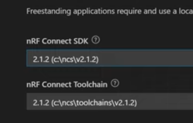

  • Hello again,

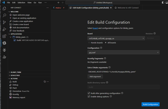

    It seems that you might be building it for the nrf5340_audio_dk_nrf5340. So the audio DK, not the normal 5340DK. Did you mean to build it for the Audio one?
    Elfving
  • Hi Elfving,
    Whichever board variant I choose the error is the same. Here I removed the audio
    and the error doesn't disappear

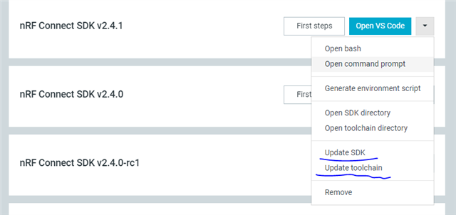

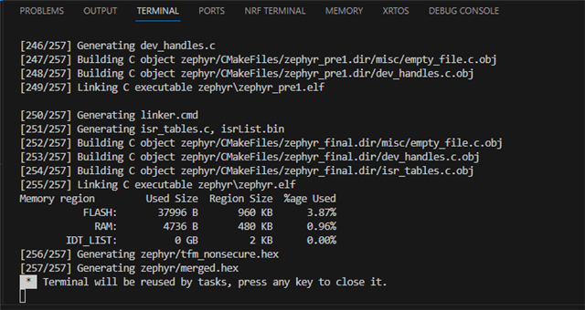

  • Hi Elfving,
    Thanks for your support! I found the solution. I have reinstalled all packages to the latest version: 1) nrf-command-line-tools-10.23.0-x64.exe 2) nrfconnect-setup-4.2.0-x64.exe . 3) I have also installed nRF Connect SDK v2.4.2
    I think that for any reason all the SDK packages had not finished installing correctly (connection interruption, light interruption, etc). Then the program could not be built because there were missing packages.

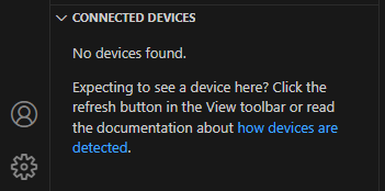

    LAST REQUEST: Now I can't flash my board, because on connected devices section it says : "No device found"
    I partially found the solution in the discussion forums. My problem is that in this new Visual Studio and SDK versions I can't find "extension settings":     vscode nrf Connect no devices found
    Where is "extension settings"?
    Regards
    Guillermo
  • Hello Guillermo,
    Great! I am so happy that you've gotten NCS on VSC up and running.
    Unfortunate that you've already gotten a new issue though. As you have reinstalled nrf command line tools, could you check that the DK shows up when running "nrfjprog -i" in a terminal?
    Elfving

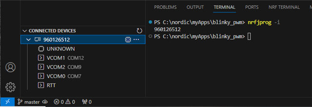

  • Hi Elfving,
    Thanks for your support! The nrF5340 DK board has been successfully detected with the number 960126512, and I assume that this device can be renamed.
    So far everything works well, I have already flashed the board successfully. Finally I request that you close this ticket, maybe in the future I will open a new ticket when I get stuck in my project.
    Yeah to rename it, simply right click the serial number and choose Rename Device.
    Please feel free to open a new ticket whenever :) We are happy to help!
